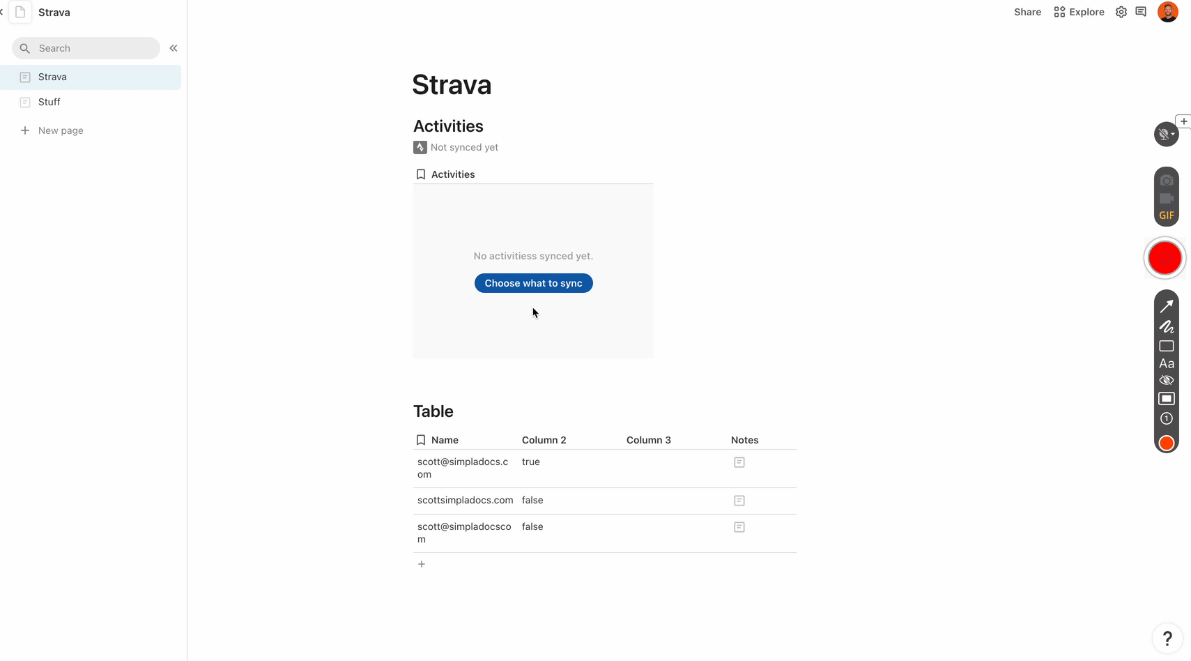

I’ve gotten the pack to finally bring me to a valid authorization page (as you saw) but now it just bumps me back to my Coda doc saying “failed to connect”
GIF Showing live bump back and fail
Screen Cast 2022-01-12 at 10.38.33 AM

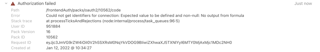

Heres the two errors my pack tools are providing:
Heres the other one
That error seems to indicate that getConnectionName isn’t returning anything. Are you using the same code that I was? You can also just remove that function from your auth definition, and it will use your Coda user name as the connection name.
VICTORY
SYNC TABLE IS WORKING
I had to erase the getConnectionName parameter as you mentioned
