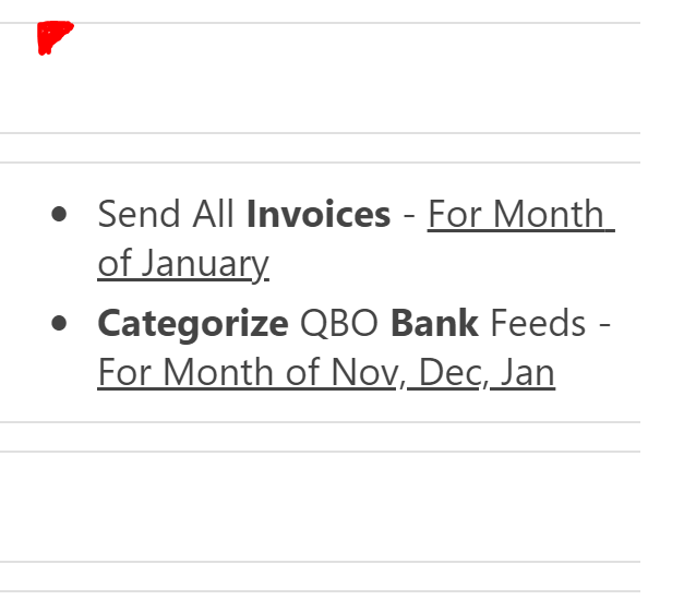

I would just have a little red flag like below in any row in that column that failed.
So the below image has three rows, the first one referenced a deleted Task and therefore had the error and red triangle flag, the second row had Tasks and they display correctly, the third row had no tasks so is correctly empty.
OK - that is actually a pretty nice result - in particular the little red flag indicating a problem.
