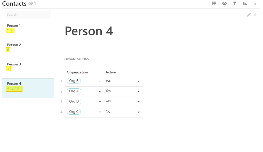

One more question: How do I get rid of the highlighted numbers in this screen?
Did I implement this correctly, can someone review this please?
It’s been a while so you may be ahead of this already. From your solution there I’d just add one more step to show the desired values instead of meaningless IDs:
Note the added Text column, all blank, is a hack to prevent displaying the “highlighted” info you pointed out. But in truth you shouldn’t need it if you refer to the org names, looks alright to me:
