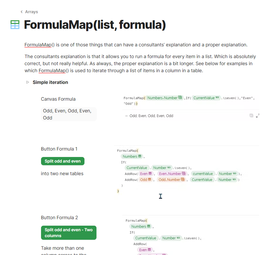

HI Kolbi,
Please see an example of FormulaMap() doing what you are looking for here.
FormulaMap() has been renamed to the more understandable ForEach(). But the original name still works.

Hi Chad,
The ForEach() formula will not copy all rows when using AddRow(). If that happens, there is an error in the formula. Please look at the example I have shared above, or share your formula so that the community can have a look and see what is going wrong.
Regards
Piet
