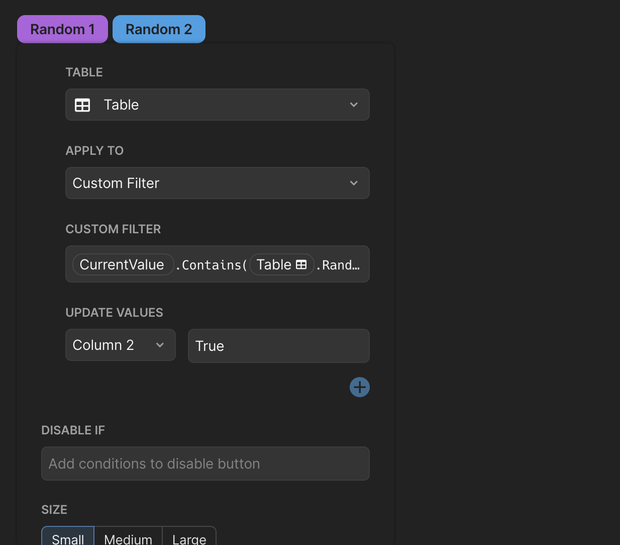

I think there’s just a condition missing in the Custom Filter of your button ![]()
(As in the Custom Filter you used Table.RandomSample(5) which is then compared to nothing)

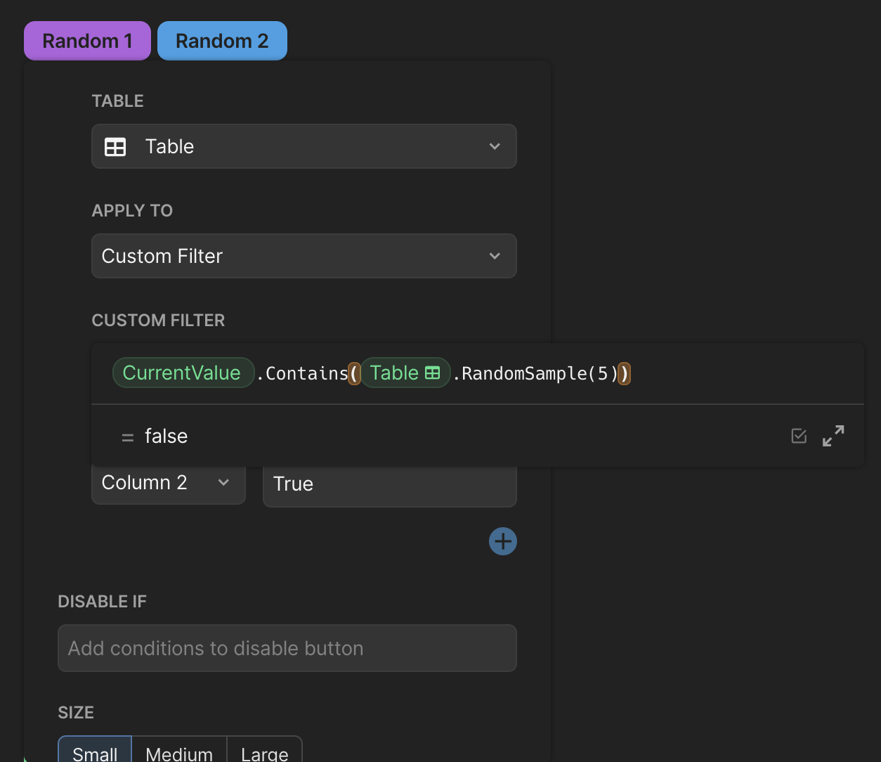

The Custom Filter could be something like (See button “Random 1” in the sample below) :
CurrentValue.Contains(Table.RandomSample(5))
CurrentValue represents here each row from your table which will then be compared to whatever rows RandomSample() is currently returning …
In other words, this will tell to the Custom Filter to keep only the rows containing the 5 random rows RandomSample() is returning and then modify the checkbox for those rows ![]()
