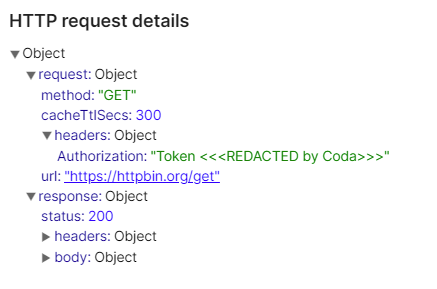

As you can see, the server is receiving my token in the Authorization header as expected. It’s also visible in the Pack logs:
Give that code a try and see if you are seeing the same behavior.
