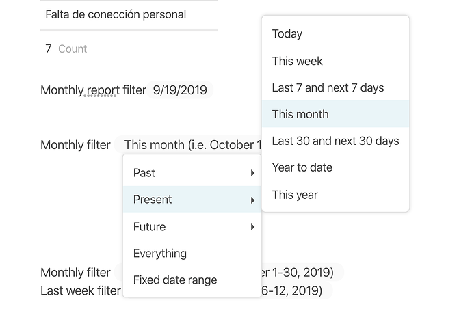

I’ve managed to solve challenge #1, auto-updating data based on the current month.
I created a control with date range, and gave that date range a “This Month” parameter:
Then in my filters I used the matches( ) formula to make it work, like so:
[Table].Filter([Date].Matches(thisMonthFormula))
It works like a charm.
