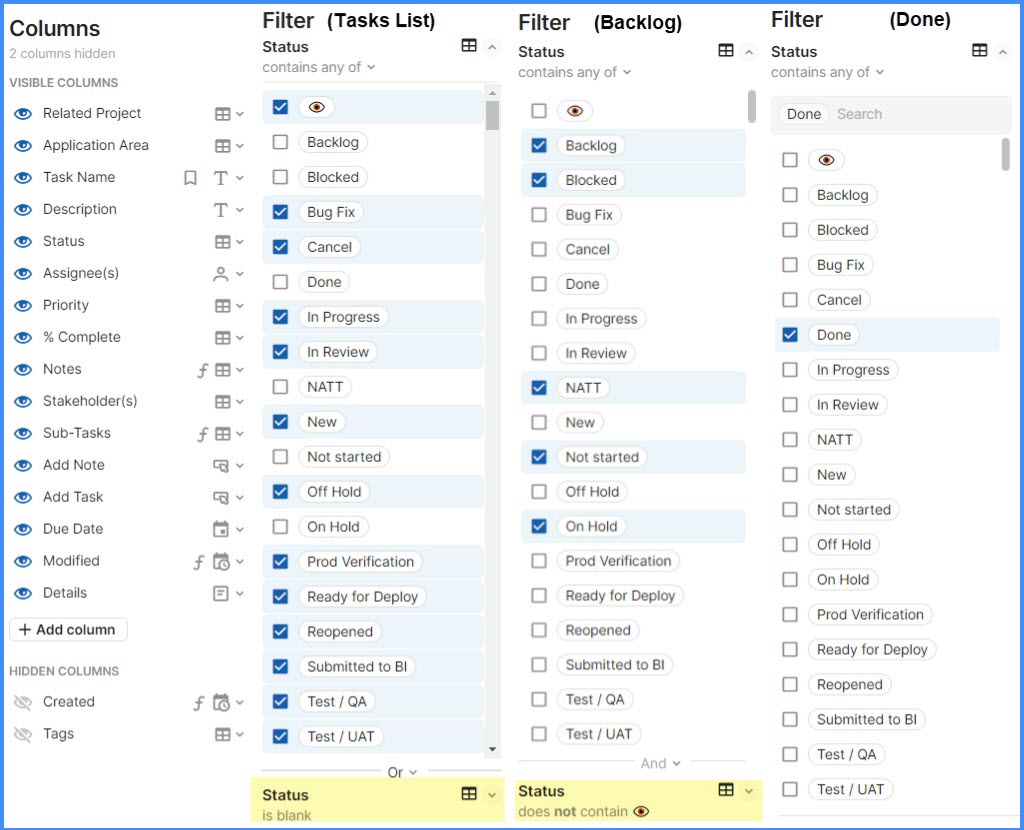

The way I designed this application, I have a “Main Tasks” table, and then I have 3-additional Views:
The Backlog View - where any tasks w/Status considered to be “backlogged” are only shown
The Completed View where ONLY tasks marked as “Done” are shown
The All Tasks View where there is no table filtering at all so all of the tasks entered into the system can be seen
These views are on separate pages w/button links at the top of all the pages for easy navigation.
I have attached the “Table Column & Filtering” settings as I released to my team for their understanding of what’s being shown within each of the views - note: as of last Monday “Cancel” has been demoted and is now considered a “Backlog” item.
The “Eye” status was a “hack” since we were originally using an Excel spreadsheet to track our tasks and there were some Backlogged items that remained on the Tasks tab - adding that to the status of a backlogged item “brings it back” to the Main tasks table recreating that behavior…
Originally I had coded the table with “reverse logic” e.g. “do not show Backlog, Blocked, Done” etc., but upon reviewing the design with my team member, I later coded it as shown, which I considered to be cleaner and easier for anyone to understand when viewing.
If you notice I do have the additional “OR Status is blank” (highlighted) at the end of the Main tasks table, so yes, when new “Blank” tasks were added, they were properly displayed.

Hi Nathan, I replied to your thread post, but I’ll also include the image I attached here as well.
My new blank row was still displayed because I added an OR term to the table filter “Or Status is Blank” as shown.
It would seem your new code logic doesn’t “drill down” into all the applied Filter terms ? Or that at least the way it’s behaving for me now.

Hi @William_Bell, if you scroll to the bottom of the list of all statuses, there should be a blank option that you can check. If you do that to include blank in that same filter condition instead of adding a second condition just to check for blank, it may work more as expected. Can you give that a try?
HI Nathan, are you referring to my Status table?
By adding a blank row at the bottom there just shows “#r33” (for the new empty row) as the last selection option in the Task table’s filter list so I’m guessing that’s not what you mean.
Re: my prior picture - as far as seeing an “is Blank” option in the upper list of selectable options, that picture is showing ALL of the available options I can choose from?
I don’t see an additional “is Blank” or “Blank” option in the table’s filter list?
I even removed the “OR term” thinking perhaps “is Blank” would return as option in the “upper” list - it didn’t? The Status is using “contains any of”, as shown in my image.
The picture I provided shows ALL of the available options in that list (I used the panoramic scroll capture with my SnagIt program to capture that whole list of options as shown?)
This is why I added the additional OR term to include “is Blank” at the end?
Maybe I’m still missing what you’re suggesting, I’ll continue looking around my table options to see if I can eliminate the OR term some other way…
Hi @William_Bell, I think I see the issue – it looks like we only show ‘blank’ as an option for contains filters in single-select columns and not multi-select columns. I’m following up with the team on that.
In the meantime, I think it may work if you put the filters in the other order (with the “is blank” condition first); to do that you may need to recreate the second filter, unfortunately.
If you only need a single status per row, you can also try converting the column to single-select; I believe you may also need to re-create the filter then to have the ability to include blank in the filter.
Thanks for the details and helping us understand what behaviors are important for your scenario!

Thanks Nathan, yes, I also felt it was the way in which Coda’s new code was looking at the “filter tree” - it wasn’t fully parsing all the terms (2-in my case with the “OR is Blank” at the end.)
My quick solution when it started happening in our meeting was to specify for the table to add a default Status of “New” for newly created rows - which fixed the issue when the team member would click the Add New Row at the bottom of the table.
I was already pre-filling the Status column as “New” with the “New Task” button I created at the top of the page.

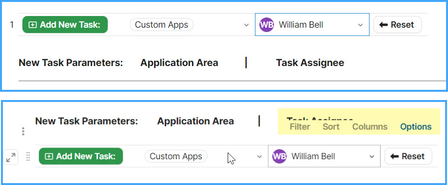

As a suggestion - I wish Coda had the option where you could specify a Hint Text value (grayed out text) for the data entry columns in the table - it would be great for prompting what the user needs to enter into new rows etc.
I had to place my hints at bottom of the ‘Parameters’ table (‘Application Area’ and ‘Assignee’), since placing that text at the top would cause part of it to get obscured due to the popup menu that reveals itself when the cursor is over the table as in the lower image…)

Hi Nathan, I just wanted to verify - I tried your suggestion about putting the blank term first before the others, and yes, doing it that way eliminated all the extra configuration and buttons I had put in as a fix…
Thanks.

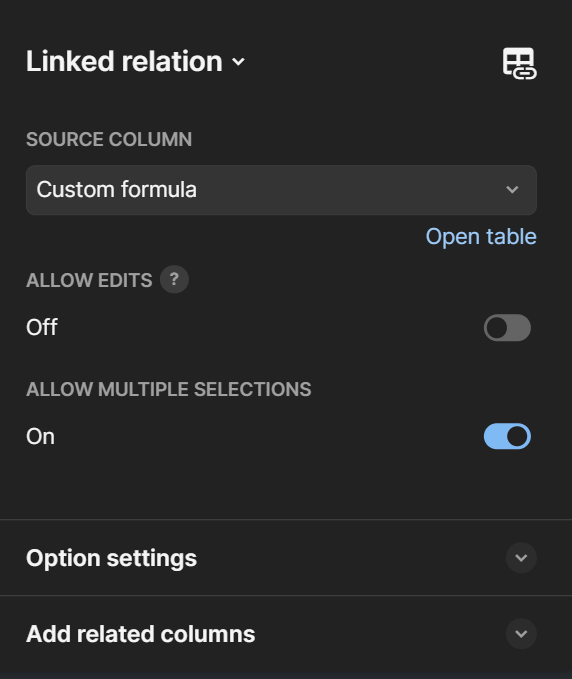

Is there an easy way to convert the formula-based previous approach to a linked relation? Thanks.
This should happen automatically. We detect the previous formula and should convert to Linked Relation if we support editing. If we don’t the column will remain as a Relation column.
Do you have an example of a formula that you expect to have converted but isn’t?

However I see it shows a Custom Formula as the Source Column, and I still see our original formula is set as the Formula. Is there any downside to this that would motivate us to change it to the I suppose new standard way?
Hi, we currently don’t support editing values projected from a relation table directly in the column. You can open the row in detail view and view it as a sub table to support editing those values.
More details on subtables here: Subtables | Coda Help Center
Hi Ed,
If the setup is working for you no need to change it. If it makes sense to enable editing on the Linked Relation for your use case, you can now toggle it on through that setting in the dialog you posted.
