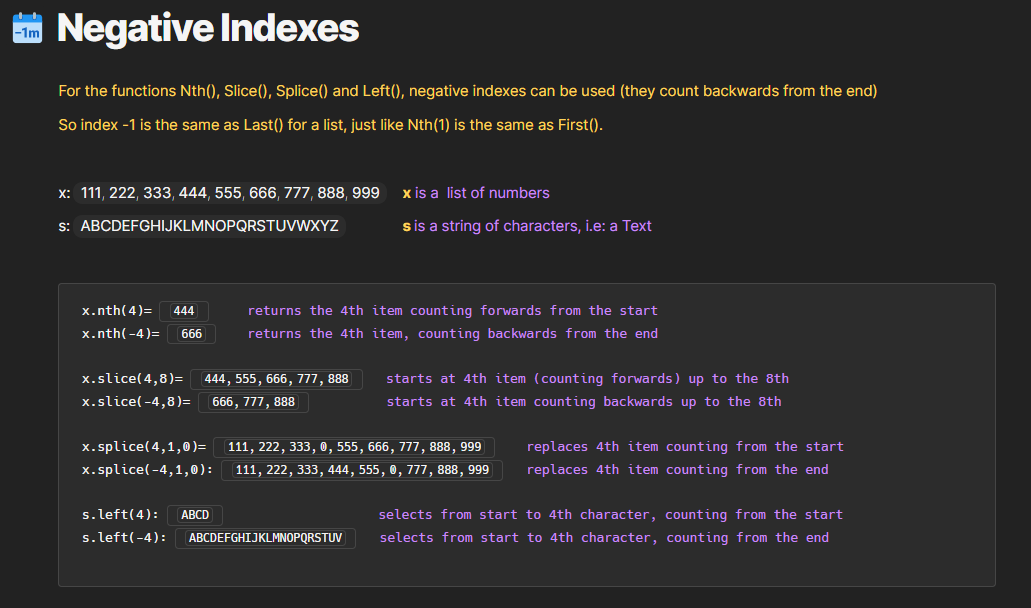

In many programming languages (eg: JavaScript, Python, Java, C#, Clojure, etc.) you can use a negative index to select items in arrays or characters in text counting from the end of the array or string.
Positive indexes count from the start. Negative indexes count from the end.
So I tried this out in Coda and it works! At least for the Nth(), Slice(), Splice() and Left() functions.
Even though this feature is not included in the documentation.
It does not work for Right() or Middle() alas.
