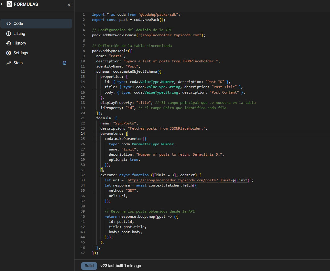

Hello everyone,
I’m trying to use pack.addSyncTable in a Coda Pack to create a sync table that fetches data from an external API. The idea is for the table to automatically update with data retrieved from the API.
However, when I try to sync the table in my Coda document, it does not populate with any data. It simply remains empty with the message: "No rows were returned during sync.
Here is the code I’m using:
import * as coda from “@codahq/packs-sdk”;
pack.addNetworkDomain(“jsonplaceholder.typicode.com”);
pack.addSyncTable({
description: “Syncs a list of posts from JSONPlaceholder.”,
identityName: “Post”,
schema: coda.makeObjectSchema({
properties: {
id: { type: coda.ValueType.Number, description: “Post ID” },
title: { type: coda.ValueType.String, description: “Post Title” },
body: { type: coda.ValueType.String, description: “Post Content” },
displayProperty: “title”,
idProperty: “id”,
formula: {
description: “Fetches posts from JSONPlaceholder.”,
parameters: [
coda.makeParameter({
type: coda.ParameterType.Number,
description: “Number of posts to fetch. Default is 5.”,
optional: true,
execute: async function ([limit = 3], context) {
let url = https://jsonplaceholder.typicode.com/posts?_limit=${limit};
let response = await context.fetcher.fetch({
method: “GET”,
url: url,
  // Returns the posts fetched from the API
  return response.body.map(post => ({
    title: post.title,
    body: post.body,
  1. The API works correctly:
    I tested the URL manually using tools like Postman and cURL, and it returns the expected data.
  2. Is this related to Coda’s plan limitations?
    Could it be that automatic table synchronization requires a paid plan?
  3. What might be wrong with the code?
    If there’s an issue with the schema, identityName, or the data being returned, I’d like to understand how to fix it.
Question:
• Why doesn’t the table populate when syncing?
• Is this related to Coda’s plan limitations, or is there something wrong with my code?
Thank you in advance for your help!
You should return an object with a result property, like this:
return {
  result: response.body.map...
Yeah or just:
let rows = response.body.rows;
return {
  result: rows

This is a jus dump version:
async execute([appKey, appSecret], context) {
      let allClients = [];
      let page = 1;
      let totalPages = 1;
      // Fetch the first page to get the total number of pages
      let firstResponse = await fetchOmieClients(context, appKey, appSecret, page);
      if (!firstResponse || !firstResponse.body) {
        return { result: [] }; // Return an empty array if no data is found
      // Get the total number of pages from the first response
      if (firstResponse.body.total_de_paginas) {
        totalPages = firstResponse.body.total_de_paginas;
      } else {
        console.error("Unexpected response format:", firstResponse);
        throw new Error("Unexpected response format: 'total_de_paginas' not found");
      // Loop through all pages
      for (let currentPage = 1; currentPage <= totalPages; currentPage++) {
        let response = await fetchOmieClients(context, appKey, appSecret, currentPage);
        if (!response || !response.body || !response.body.clientes_cadastro) {
          continue; // Skip to the next page if there's an error or no data
        // Push the retrieved clients to the allClients array
       //let allClientss[] = response.body.clientes_cadastro;
        return { result: response.body.clientes_cadastro}; // Return the array of all client data
Thak so much once again…
Hi
you can use continuation :
execute: async function ([], context) {
      let page: number = (context.sync.continuation?.page as number) || 1;
      const url: string = `${BASE_URL}/v2/invoices?page=${page}`;
      const res = await myFunctionFetch(url, headers, .... etc);
      // I map to link 2 tables together
      const results = res.body.invoices.map(invoice => linkInvoiceToCustomer(invoice));
      // else just
      // set page or undefined if undefined the function will not be relaunched
      const continuation = res.body.total_pages > page ? { page: page + 1 } : undefined;
      return {
        result: results,
        continuation
