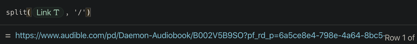

I want to take some URLs and chop off all the tracking. I noticed in the URLs the mess comes after the ?
To pull up the book I only need: https://www.audible.com/pd/Daemon-Audiobook/B002V5B9SO
Me thought it clever to split() the array and then take first(). For some reason it won’t split! After question mark wouldn’t work I thought maybe ‘/’ - see below. Thoughts?

What is the actual content of the cell?
Have you tried with Link.toText().Split("/")?
@Federico_Stefanato !!! yes it needed to be converted to text. Although I pasted it in as text, Coda did an end run and transformed it into not-text. Thank you! :pray:

Even though if you need to take out the query parameters, maybe it’s easier go with Left() and Find() functions searching for the “?”.

I guess that splitting an URL in slashes and taking the first occurrence would return “http:” :grimacing:
You’re not searching for “/” but for “?”, as far as I understood.
If you need a string before a certain string/character, it is usually better search for the occurrence and cut it after.

Just realised that perhaps you intended splitting by “?”.
Which does work :upside_down_face:
