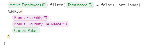

I knew someone would come in hear saying FormulaMap was the right answer so I started looking to convert mine. Here is what I ended up with:
[Active Employees].filter(Terminated = false).FormulaMap(
AddRow(
[Bonus Eligibility],
[Bonus Eligibility].[DA Name],
CurrentValue
You could remove the filter if it doesn’t apply to you. Active Employees is my employee list and Bonus Eligibility is my target table (your timesheet table).
