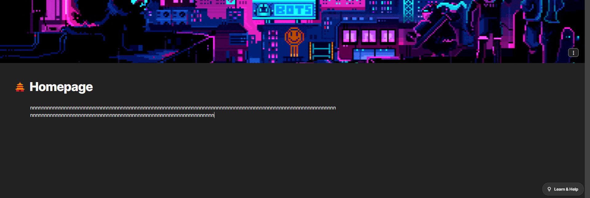

Are Coda's pages supposed to be aligned slightly to the left? My OCD really hates it. Is there a way to fix it?
This is what all of my pages look like. Honestly, it might be a dealbreaker for me if there isn’t a way to fix this.

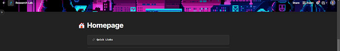

this is what it looks like, on wide mode, on a larger monitor
How does it look on standard mode? Not sure I understand what you mean
I want to believe that whatever is defined as the pages left and right edges, basically the part of a page that can hold text, should be centered.
This way you get even padding (margins) on both to the lefthandside and the righthandside of the active page.
I guess it’s food for thought for the designers…
it’s not centered on standard mode either… the right margin is bigger than the left margin on both modes.
Cool now I see what you mean!
