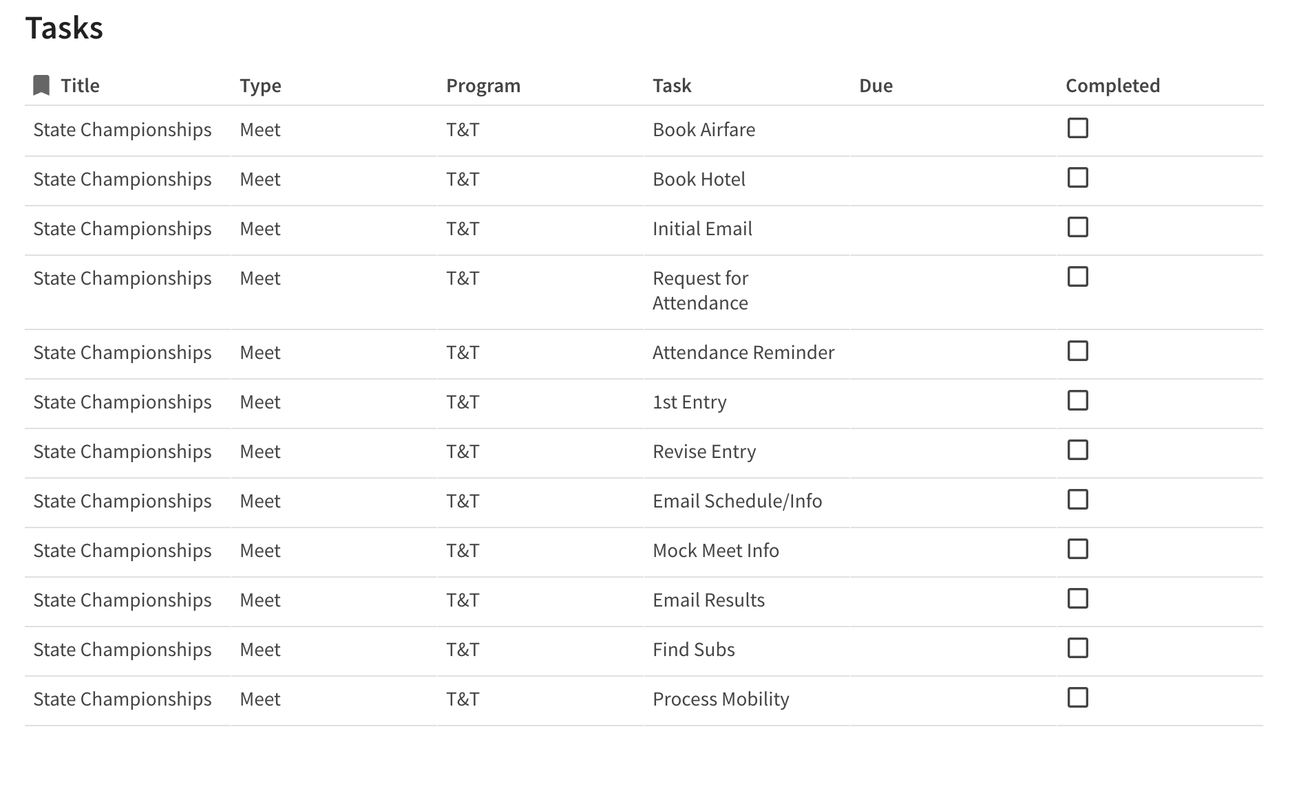

I’m trying to create a system that will automatically schedule my tasks based on the date of the event and things that need to get done based on that date. For example, given we have a meet coming up on [date], I know I need to book airfare x days in advance, submit our entries y days in advance, and send out results to the team z days after the event. I have tried to use FormulaMap(), however it doesn’t seem to let me fill out all the columns. I am probably just using it incorrectly, but does anyone have any advice on how to accomplish this?
Here is what I have so far, however CurrentValue.Task does not seem to work and throws an exception.
Configurations.FormulaMap(AddOrModifyRows(Tasks,true,Title,thisRow.Title,Type,thisRow.Type,Program,thisRow.Program,Tasks.Task,CurrentValue.Task))
Thank you in advance!

Here is a screenshot of your formula the (hopefully) correct results:
And your complete formula:
Configurations.FormulaMap(AddRow(Tasks,Title,Title,Type,Type,Program,Program,Task,Task,Due,[Start Date]+Days))
PS - You were using AddOrModifyRows() before, and I changed it to an AddRows(). Is there a reason you wanted to use the potential “modify” part?

Sorry took so long to reply. Thank you so much for your help. Those colors are a great addition to the formulas and clearly I should have been paying more attention to them. Formula is working and all is good. Thanks again Lloyd.
Austin
