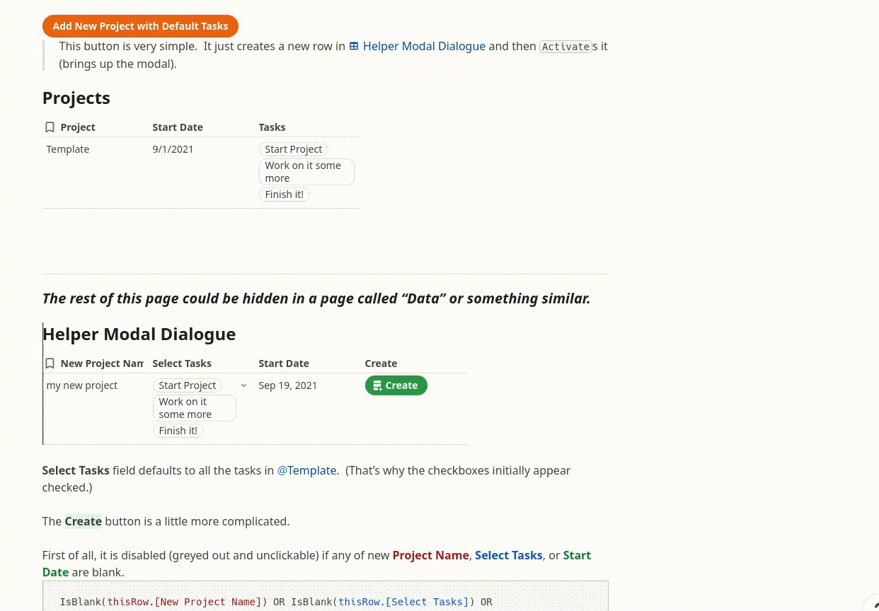

Here’s a trick I learned from Paul_Danyliuk that might help you: using a modal view of a row as an intermediary dialogue for cases just like this — when you want to create a row (or rows) with some added input from the user.
Check out this example:

Hey Carl, happy to help :slightly_smiling_face:
One clarifying question then, since you say that the template projects, along with their tasks, are coming in via Cross-Doc and cannot be altered locally, where are you putting the newly created tasks? Are you placing them in a separate table in the current doc? And if so, will they be synced back to this master table somehow?
The doc I made puts the new tasks right back into the same table that the template tasks are stored in. It could easily be made a separate table as well, if that’s what you want to do. Otherwise, I think it already does what you want you explained to me you want to do. I put in some more clarifying notes into the bottom of the page there, I hope that helps. :slightly_smiling_face:
By the way, that style of explaining formulae I learned from @Connor_McCormick1 :wink:
Ok, I just changed the structure of the doc to help match your scenario, and make it a little bit more logical, albeit a little more complicated. Notes in the doc.

Hi Carl,
Of course you can change where the tasks are from — that is as simple as changing the formula for the default value of tasks.
output
You can also easily do without the project table — then just skip the blue part of the formula, and instead of [new project] put a string like "My Cool Project". Then you would have to go back to the formula you wrote for determining task due date, since it can no longer get the start date from the Project. Specifically, the last purple line would change to:
Tasks.[Due Date], thisRow.[Start Date] + CurrentValue.Offset
The last table, called “Helper Modal Dialogue” is the one that is giving you the pop-up form, so you can’t get rid of that one. But you can definitely hide it away by putting it on another page and the user never needs to see it. And by the way, you can also do the same thing with the project table, which might be better than deleting it altogether.
