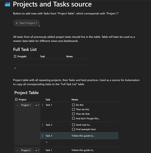

This works vert well when getting rows from a table that looks up the value of “Project” from another table as illustrated in this image:
When the Project column is change to a plain text field for the Projects, this no longer works. I can’t find the current value of Project, or selecting the actual value of “Project 1”. Just a string of “Project 1”
What’s the logic behind this? Do I have to have a predefined objekt? Like a tag, or a single lookup value from another table to make it work? Maybe @Connor_McCormick would know?
