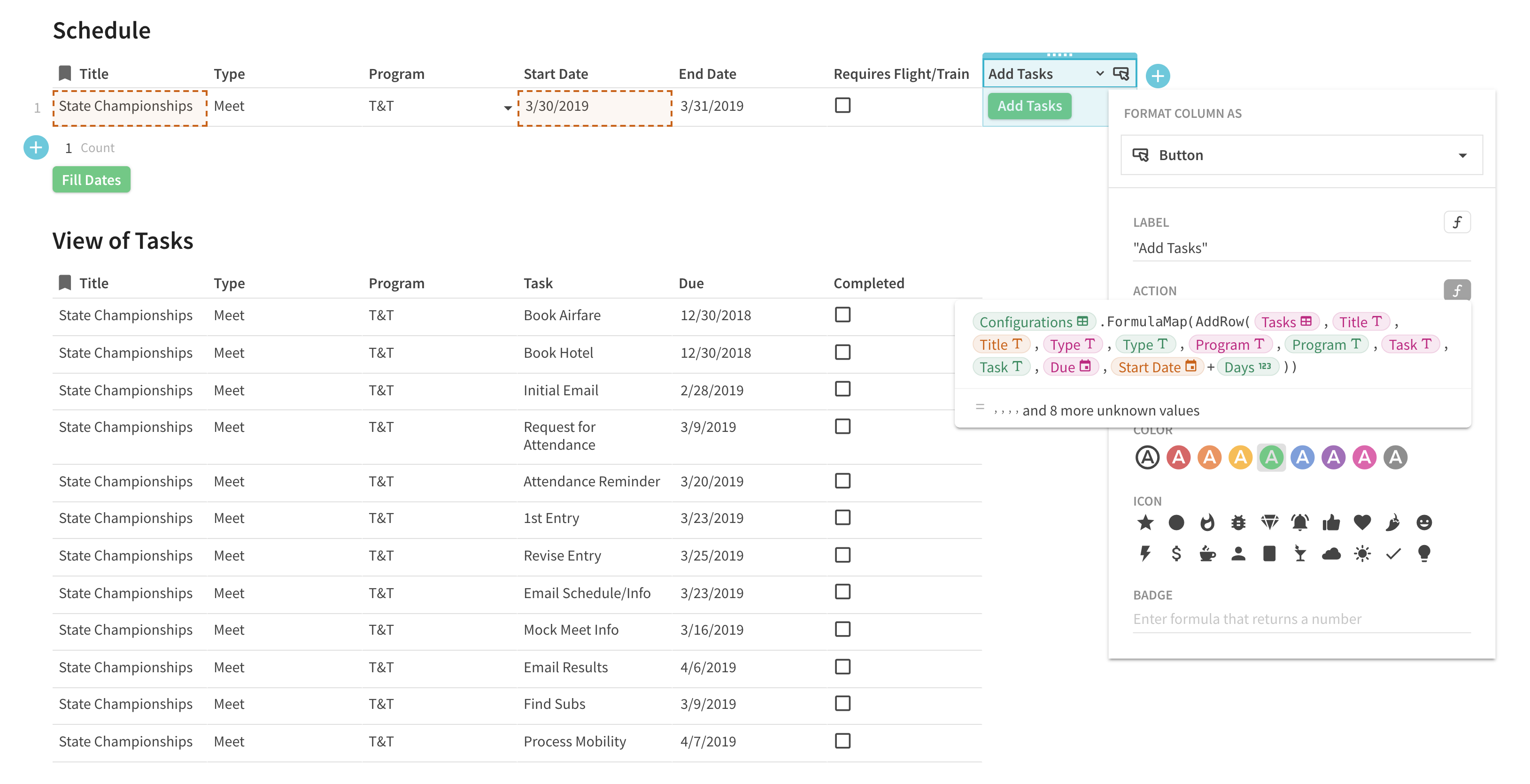

Here is a screenshot of your formula the (hopefully) correct results:
And your complete formula:
Configurations.FormulaMap(AddRow(Tasks,Title,Title,Type,Type,Program,Program,Task,Task,Due,[Start Date]+Days))
