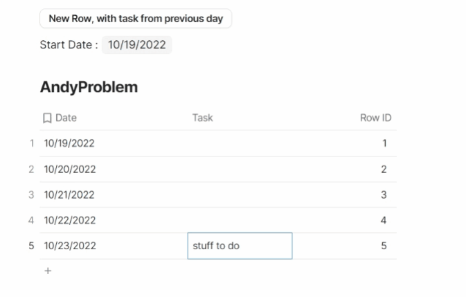

Hi @Andy_Farquharson ,
Not sure I understand well yor point, but trying this : you want to add new row for a new day, and that stuff in the previous row are copied in the new one, right ?
If yes, try configuring your button this way, and the date as well as showed >
Button configuration
Date Configuration*
Live Action : The text of “Task” Column is copied to the next day
CPT2210191833-673x429

Hi @Piet_Strydom !
About that indeed, I wrote something I would not use my self, I thought about that after posting and told myself I needed to come back here to correct ! You’re faster than me !
In pratice, it was an example of how to autofill date, but indeed this is not stable, and there are many ways to create this id-like. Probably the best idea would be to use daily automation that would trigger the button, and add to the button the adding of the current date when it’s triggering. May be OP would like to manually push the button each day, I don’t know.
But for the main point, I fully agree with you to the fact that in the main use case, we cannot use RowId as relevant tracker !

I would create the column CreatedOn() that will be filled automatically, and a column to rank your row according to the CreatedOn column, something like Rank(thisRow.[Created on],thisTable.[Created on],True() )
That should replace the RowId, without missing anything
