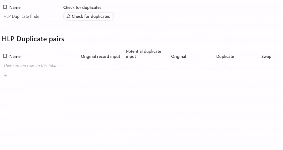

- Implement an Iterator table like I usually do for this and like you see above.

I often advocate for the third solution because it’s the most flexible:
- You can split your process down into separate clear steps (but you don’t have to)
- If split into steps, you can manually test each step (e.g. unit-test how your button that merges two contacts would do so on two arbitrary contacts that you’ve picked, not run the whole process)
- You can build extra indication, e.g. a progress bar to show you how dupe checking is going
- It’s good practice to separate logic from data
