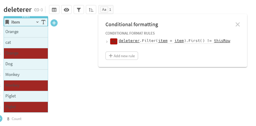

I was keen to create a button that removes the duplicate rows. using mallika’s formula, but have com up short, seems like no matter how i modify it, it just deletes everything. If anyone has any ideas it would be greatly appreciated.
@shishir Amazing thank you so much. This works perfectly. At first i was thinking that it all should be in one super formula attached to the button, but splitting it up into a couple of rows makes it so much easier to digest and is much more illustrative for another editor to come in and manipulate.

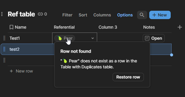

Hi, I would just like to mention that this solution does not relink relations in other tables, it actually breaks the relations that were attached to the 2nd instance of the duplicate.
Not a fully rounded solution unfortunately, if anyone knows a better one it would be super useful
Sample of the issue:
Sample doc showing the result of deduping and the broken reference:
