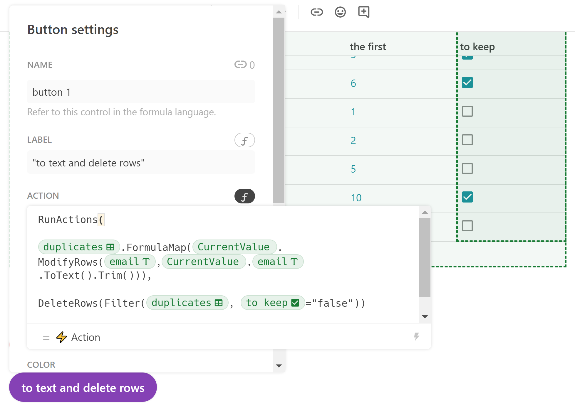

the button goes as below:

I assume you want to push only one button to have only unique email addresses in text format. I borrow some insight from @joost_mineur:
  • that is a good start to first delete possible spaces (you do not see, but can be there) using Trim()
  • how to use a ModifyRows in combi with a CurrentValue without using Nth()
The name of the table is duplicates and the button links to this table and executes 3 actions: We skipp the edu part, enjoy the formula:
RunActions(
duplicates.FormulaMap(CurrentValue.
ModifyRows(email,CurrentValue.email.ToText().Trim())),
DeleteRows(Filter(duplicates, [to keep]="false"))
best, Christiaan
