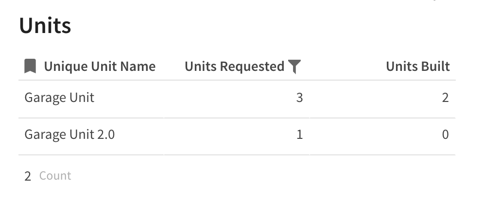

I am trying to list the elements in a table, but I’m having a problem. I want to only list each Unique Unit Name once. I have a key row that has a double listing and I only want a single list from the double list. I want it to only look like this:

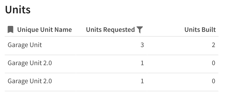

But instead I get this:

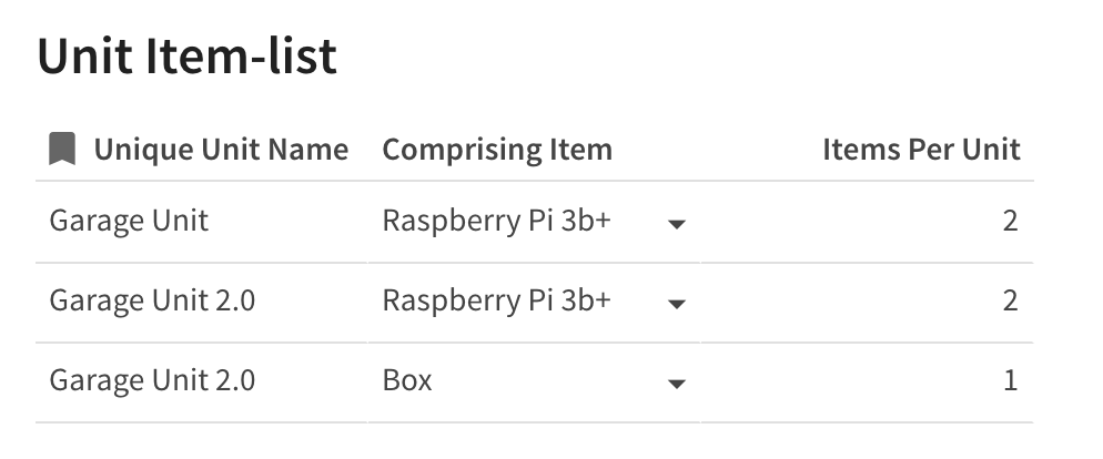

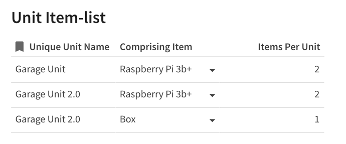

I understand it is because I am taking from a table that looks like this:
But I want to know how I could list only one of the two rows that refer to the same Unique Unit Name (I’ve tried .Unique() it didn’t work). It’s like I need .Unique() for existing rows in tables.
Try this filter -
thisTable.Filter([Unique Unit Name]=thisRow.[Unique Unit Name]).First()=thisRow
Ah, brilliant, just what I needed. Would be nice if there were a more intuitive way to do that, it seems like I often find myself trying to compress a table with many-to-one attributes into a table of just the one attribute.
