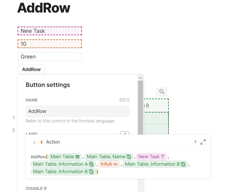

Hi @Pedro_Jimenez

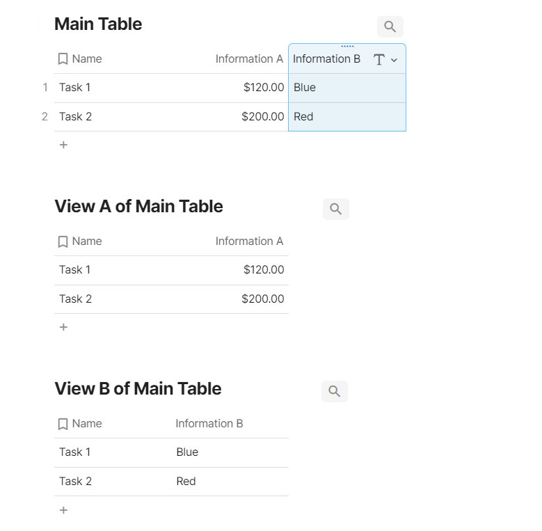

The whole of view from table is that it shows filtered view of the same table
Then if you add any information in the main table, you can display it in any view
FOr example, i’ve got a main table, and view A that shows info A and view B, that shows info B
IF you add a row using this button it will be displayed in both view
Let me know if this is ok for you ?
