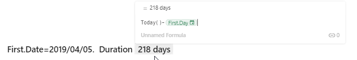

I did stumble upon a curious case, however by trying to check difference between two dates. Let’s take some date First.Day and get the duration between it and Today() by simply subtracting Today()-First.Day. We get duration X expressed as duration and written as “Days”. This X is less by one if I count Today(). So I try to add one day by adding Today()-First.Day+Days(1). And the result unfortunately gives me not duration anymore but Date format. That is quite puzzling. Here are the screenshots:
Any idea how to fix that?

For your second problem, could you try this :slight_smile: :
Today()-[First.Day]+Days(1).DateTimeTruncate("day")
Excellent. If I understand correctly, the Days(1) would yield a DateTime value and not Duration. THANK YOU!
I must admit I’m not sure about why this is working :thinking:
But I’ve found another way to fix this too with this formula (which kind of “feels” more logical to me) :
Days(ToDays(Today()-[First.Day])+Days(1))

The corrected formula is :
Days(Today()-[First.Day]+Days(1))
:slight_smile:
This is very clear - one format push onto entire equation! :wink: @Pch - if you are so kind to help, please have a look at couple more challenges I have posted. Any insight is truly appreciated!
