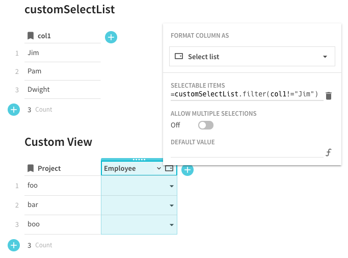

How is the select list in your master table currently populated? Not sure if this would solve your challenge, but I would store the list of selectable items in a different table and then each view built off of the master table would filter out the values you don’t need. In the example below, the select list in the “Employee” column would only show the names Pam and Dwight:
