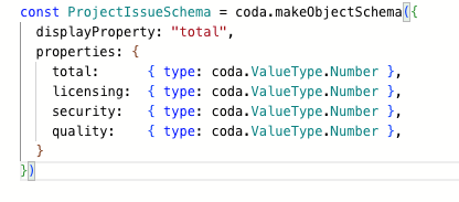

The sync table property is called issues and is setup like this:
The ProjectIssueSchema is an object with all number fields. The display property is the total of all the numbers.
The tables column data type is a Text field instead of a number:
Manually changing the column type in the table via the UI to a Number removes the object.
Is there a way to declare the nested schema column’s data type to a number instead of text?
Hi @Ryan_Hubbard1 - The short answer is no, you can’t get an object schema to behave like a number column. In cases where there is only a single nested object, the best solution would likely be to flatten it out, removing the nested schema and adding more properties to the top-level schema. So Issues.Total should be flattened to TotalIssues, etc.
