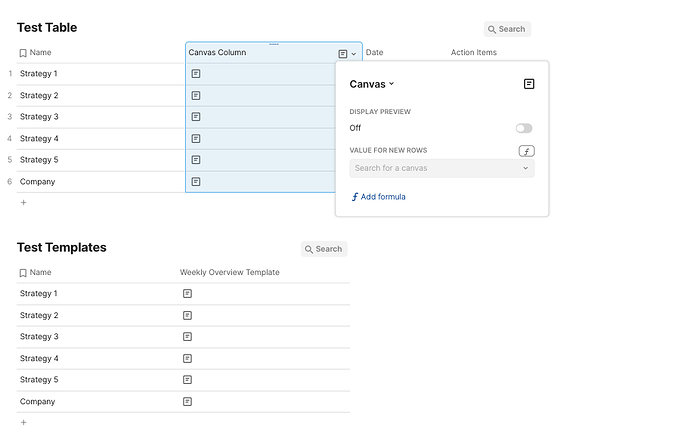

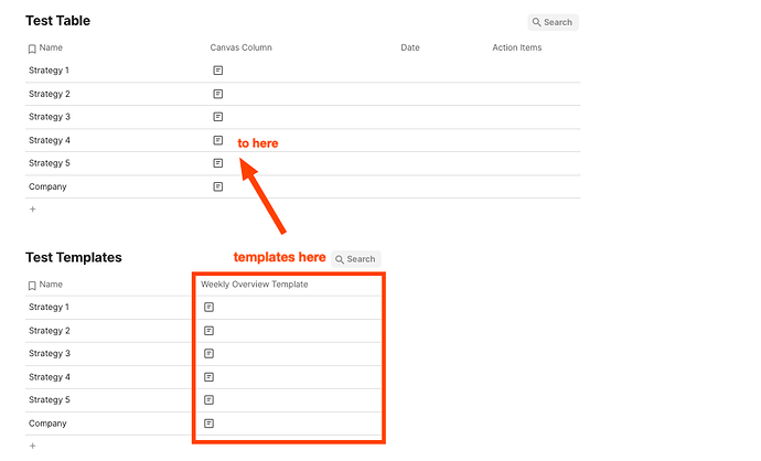

I am creating a table where I have a canvas column (Test Table.Canvas Column) that I would want to auto-populate a template from a canvas column in another table (Test Templates.Weekly Overview Template), depending on the Name.
Is there a formula I could use, such as IF STATEMENTS, to filter by name and populate the template into the table?
Having a formula embedded into the Value for New Rows field would be ideal. I am not sure, however, if you can do this functionality across tables.
hello Tanveer, what I would do to simplify the formula is include a Lookup column in your table Test Table that points to the row in the table Test Template that has the same name. The formula for this column is like so
[Test Template].Filter(Name=thisRow.Name)
Then add a button column to Test Table that fills the Canvas Column with the Weekly Overview Template from the Lookup column
ModifyRows(thisRow,thisRow.[Canvas Column],thisRow.Lookup.[Weekly Overview Template])
Then you can add a button that pushes that button for each row
RunActions([Test Table].Button)
after doing that the Canvas Column from Test table will all be equal to the Weekly Overview Template from the Test Template column

you can define a formula for the initial value for your canvas-column that is run each time a new row is created in your table.
look at the option for “canvas column options” in the column heading menu. there is a place there to define values for new rows. put in the formula there. it will be executed when a new row is created. and then the user can edit the contents later.
