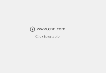

Many URLs require responding to a “Click to Enable” screen in Coda before being displayed as an EMBED.
Is there any workaround to this? If it is my own site I am trying to embed, is there something I can do so the Click to Embed is not needed?

Hey Richard, happy holidays! When loaded in “force=true”, mode, third-party embedded sites like yours may not load for other users properly depending on factors like the browser in use, whether they’re logged into the site, etc. Furthermore, these third-party sites can log some tracking information about users and slow the doc down, so that’s why we have this disclaimer in place.
Once you enable a site on your device, it should be remembered there and you shouldn’t have to click it again. We’ve had some discussions to let domain admins have a “whitelist” of sites that don’t need to be enabled, but had put off that work for now. Thanks for the feedback though, as that’s something we can look into in the future again.

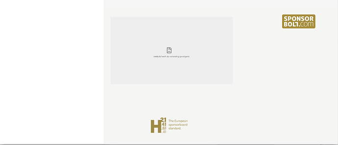

It appears to me that no Embeds at all work when displaying a Coda doc in an iFrame; even “standard” Embeds that you support such as YouTube do not appear when I display the document in an iFrame as previously discussed in the thread referenced below… is this correct? Thus it seems that if I want to make a public-facing document, i.e. one which does not require that the reader have a Google account and login to Coda, then I cannot use Embeds in my public facing document - is that right?

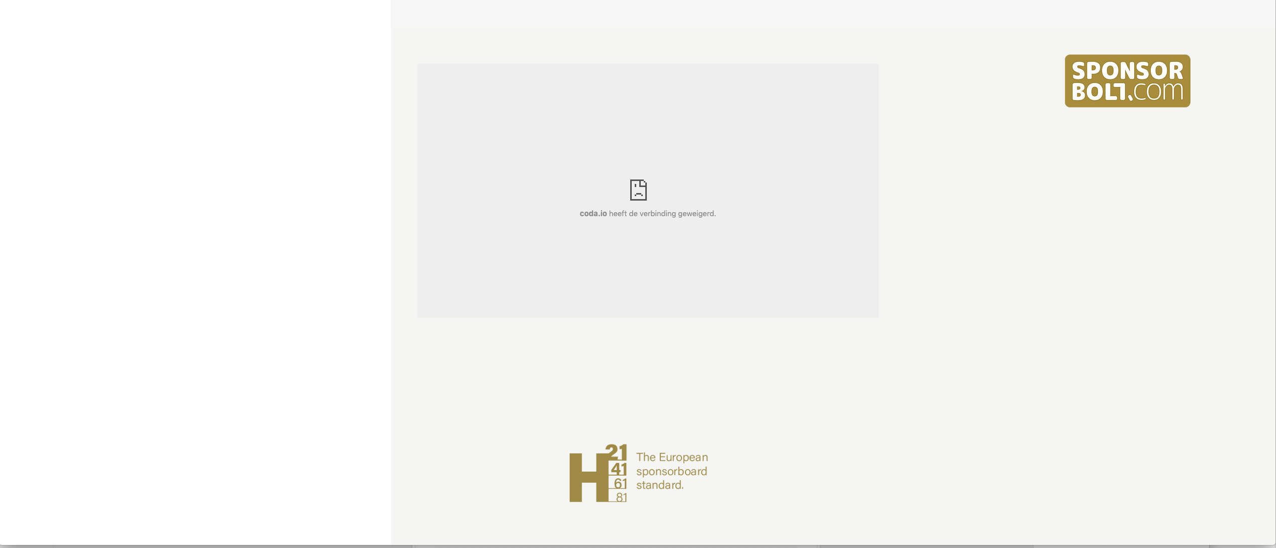

Hello Oleg, experimenting with the benefits of CODA over Airtable I bumped into the same iframe issue as @Richard_Kaplan almost a year ago. Although I am a CODA newbie it seems all (security) settings are set correctly. I am very curious what the actual status is of this issue. Can you respond asap? Thank you!
