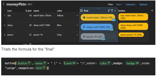

I want to customize the color of every button color/icon in a table-based button. I want it to be more colorful and I don’t want to have the same color/icon for every single button. Maybe if you have multiple stages of a task (e.g. started, in progress, finished, checked) and to get to the next stage, you press the button. But e.g. i want to make the button orange if I’m in the progress stage, then the button turns green as soon I am in the finished stage. The same for icons.

Thanks! I found a way to change the color of the button with a seperate formula.

I did it like this:

@Nikola_Liebetrau Thank you for sharing. It is a nice solution, but there have been some warnings against using the button() function. For my most important docs I can’t risk that I might run into a problem if this function ends up unsupported some day. But I have to admit, it works nicely in your sample.
thanks for the message! i hope that these parameters will be integrated into the standart button, that would make things mich easier.
