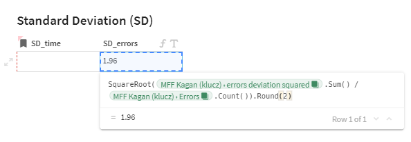

Below is an example of using the same formula that works. The only difference is that there is no filtering.

It’s going to be easier if you just share the doc so we can take a proper look, but now it looks like inside the SquareRoot function you’re trying to divide the sum of a list of numbers by a list - you can’t divide a number by a list.
Notice in the version that works you’re dividing the sum of a list of numbers by the count of a list of numbers (i.e. dividing a number by another number) - do you just need to move the close bracket of the SquareRoot function to after the Count() instead of before it? That way it will match the version that works.
