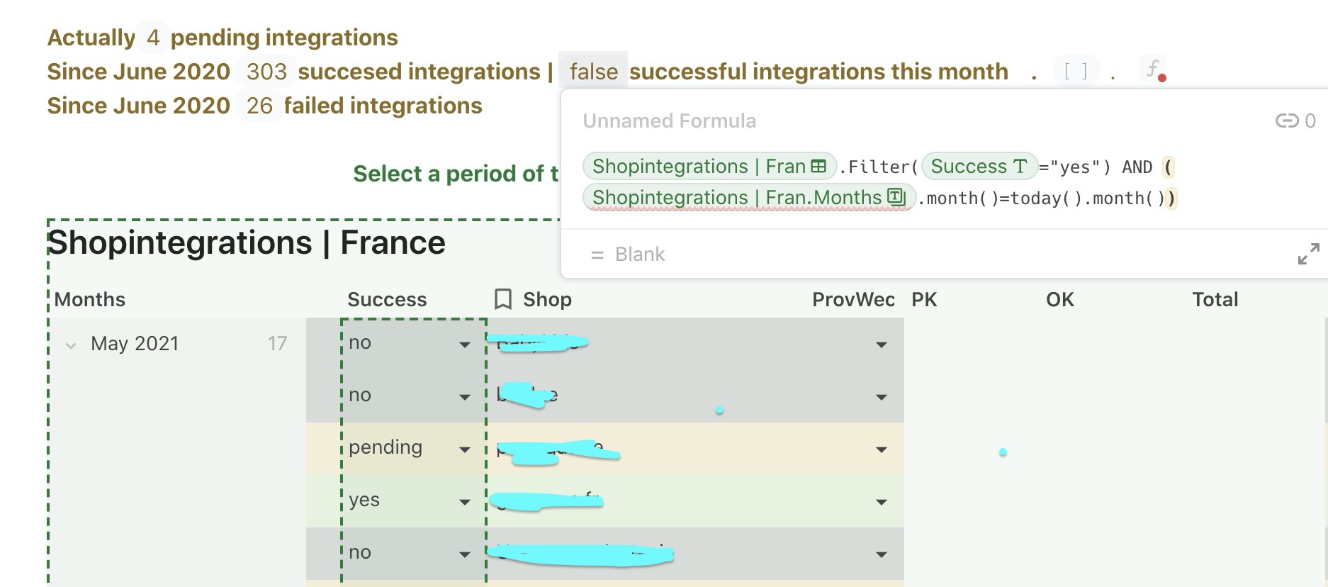

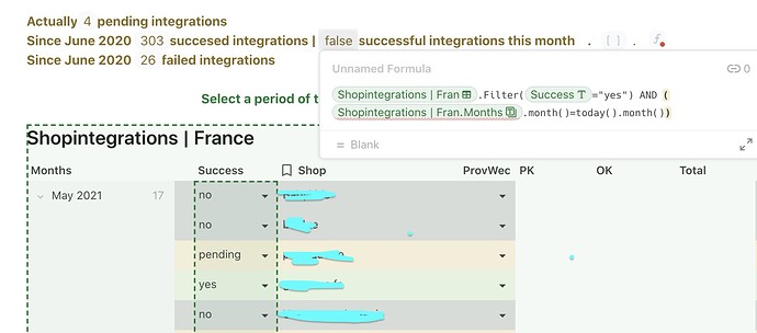

Hello Federico,
thank you for your approach, but it is not really what I am looking for.
This screenshot will probably help to understand.
Do somebody have an idea how to show a number as a result of a Success status and the actual month?
Thanks a lot in advance,
Vincent
Hi @Vincent_Guibert ,
try this:
Shopintegrations | France
   .Filter(Success="yes" AND Months.Month() = Today().Month())
      .Count()
Let me know if this helps.
Cheers!
