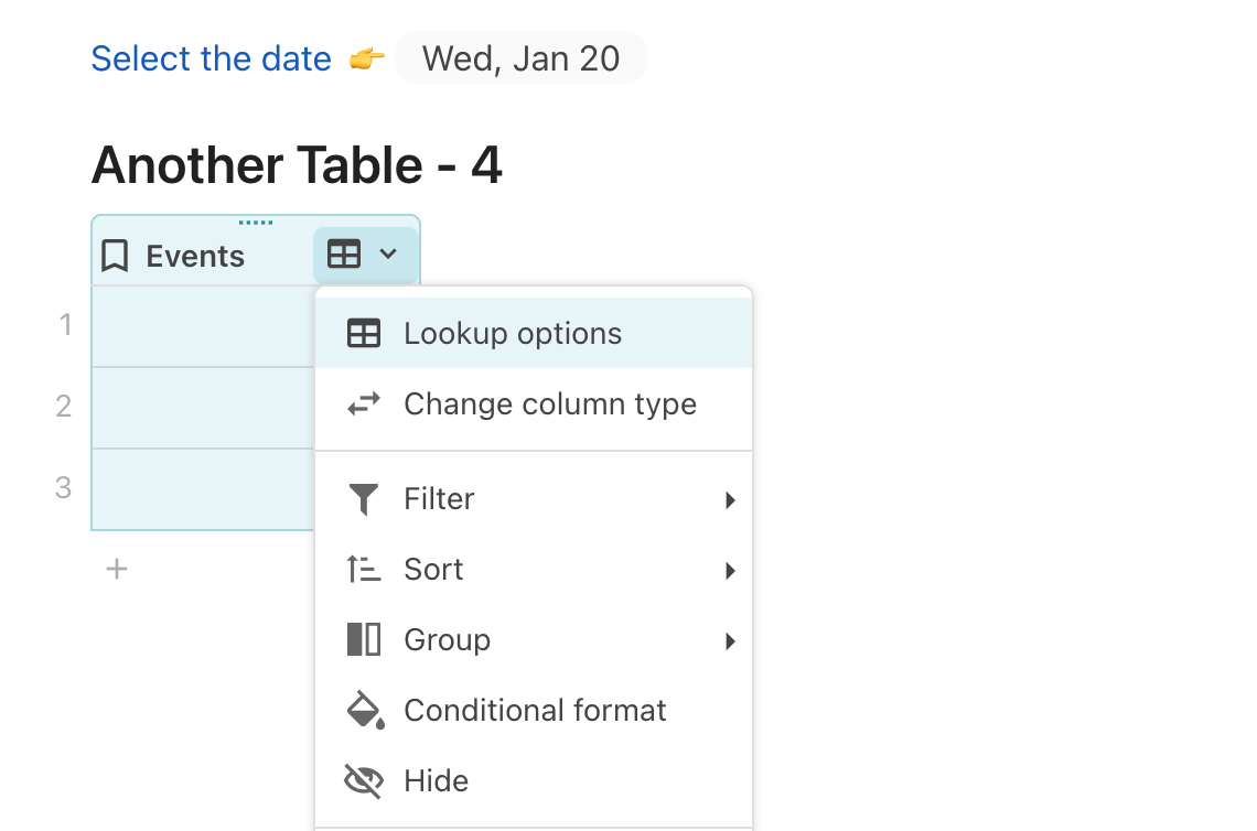

In your other table, once you’ve created your Lookup field (following this path : Right-Click on the appropriated field → Change column typeLookup (somewhere near the bottom of the menu) → select your table Events) go to Lookup options. Once there, look for Item settings then go to Filter. In the dropdown menu, select Custom filter and click on Add filter.

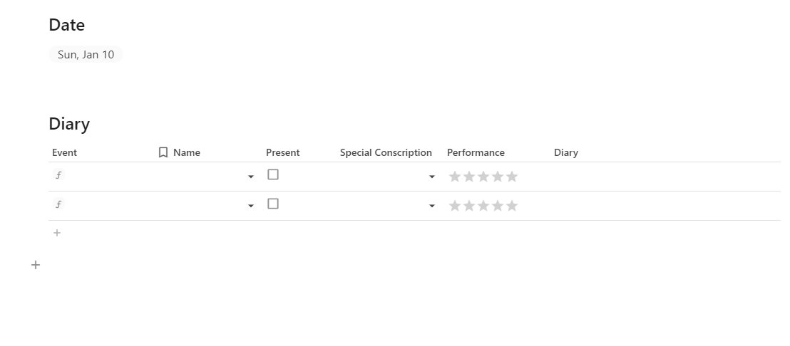

Incredible and detailed response, thank you so much. I can see why you are a community champion. However, I should have clarified that while I only care about the day of the week that events are on in the Events table, the “select day of the week” is needed to be a specific date-- as the goal of the sheet is to track attendance of individuals per event on any given date (which all gets saved to a log).
I’ve got everything else figured out, but as we have about 30 different events throughout the week, I was trying to make the logging process much easier by only showing the events that are hosted on the day of the week of the selected event.
See below:

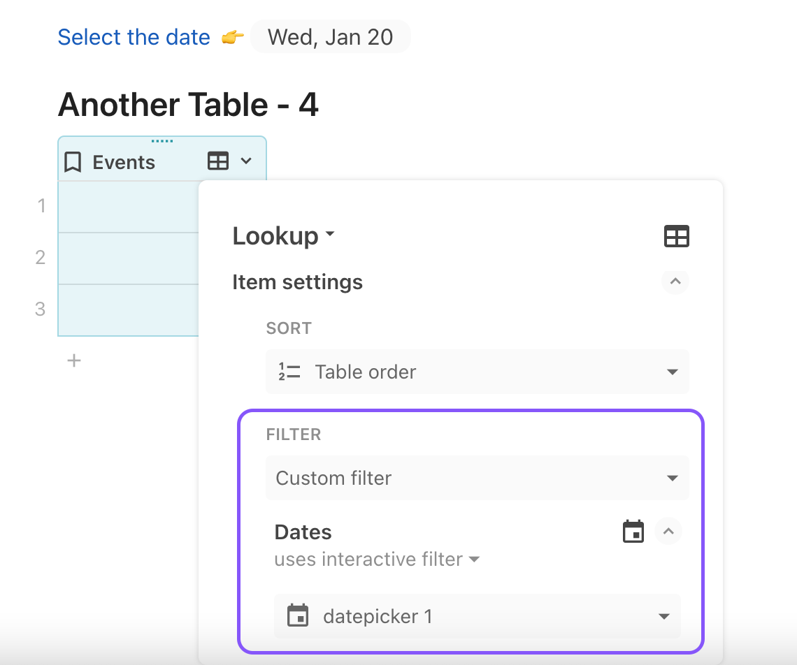

Oh ! I see :blush: ! This should simplify things :grin:
And you also already have a datepicker on the canvas :grin: .
As far as I can say, you just literally need to use your datepicker as an interactive filter in item settings in the options of your Lookup field Event and it will give you only the events occurring on the date you chose in your datepicker :blush: .
