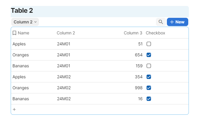

[Table 2].Filter(Checkbox=true).FormulaMap(RunActions(AddRow([Table 3],[Table 3].Name,CurrentValue.Name,[Table 3].[Column 2],CurrentValue.[Column 2],[Table 3].[Column 3],CurrentValue.[Column 3]),ModifyRows(CurrentValue,[Column 2],“”,[Column 3],“”,Checkbox,false)))
What I’d like to know though, is how I can have the above formula filter table 2 for ticked checkboxes as well as whatever the active filters in the table 2 filter bar are, for example, if I only wanted to add the rows where the checkbox is ticked AND column 2 = whatever value I’ve got the table filtered on (24M02 for example, so only the bottom three rows are moved to table 3

Step 1) make a view of your table.
Step 2) add some filters to the filter bar
make a button with the following formula:
DuplicateRows([View of My_Table].Filter(checkbox))
Please not: if you want only the visible rows with the checkbox ticked, you don’t have to type checkbox=true(), just typing checkbox will suffice (if the name of the column is checkbox).
Using the formula above duplicate the visible rows in the filtered table, but only if the checkbox is ticked.
This only works with a view of your table not if you are using your main table. Generally speaking, you want to keep your main table somewhere else in your doc (like a hidden page with all your main or source tables). If you use the above formula on your main table, all rows with a ticked box (visible or not) would be duplicated,
