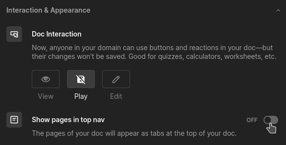

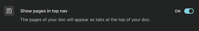

Publish your document! This will allow anyone to see/view the data in it without having to create a Coda account. Make sure when you publish under âInteraction and Appearanceâ that you turn on the option to show pages in the top nav bar - this will take away the universal search bar and help increase security in your low security solution

Note: you must be sure to uncheck âShow pages in top navâ, otherwise the URL parameter has no effect.
