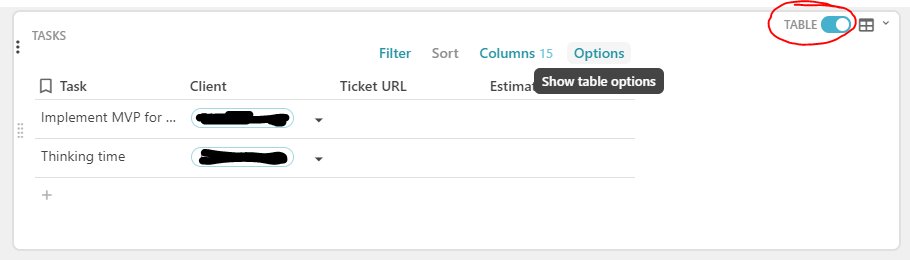

I editing the Layout for a table. I mistakenly turned of the table view for a column and I can’t get it back on. any clues on how to do this?
Hi Mark,
Is it possible to share a screenshot of what you’re talking about?
When editing the layout (I assume you mean you’re editing a “Row detail” layout for a table), look for this toggle:
Note that you’ll only see it if the column is of type Lookup and the “Multiple icons” toggle is turned on if the column contains list-of-rows values from the same table (e.g. lists of rows from Tasks table).

Hello @Paul_Danyliuk
I am trying to reproduce your table with the little table switch (top right), but I can’t get it no matter what I do. But I don’t understand the layout editing procedure, not with the screenprint you included. I have edited layouts, but then I see something completely different. Could you please clarify what is going on?
