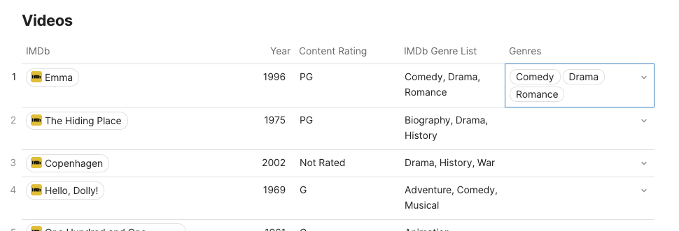

I am using the IMDb pack to manage my videos. This handy pack creates a column of comma delineated genre tags I named “IMDb Genre List”. I want to map this list into a separate lookup table called “Genres” as shown below…
For this screenshot, I manually selected the Genres… How do I get coda to do this for me?

Hi @Alan_Larsen1 - I’m the creator of the Pack, glad you’re enjoying it!
This took me a bit of hacking to get right, but here’s the formula that worked for me:

This works perfectly - thanks so much for the ideas and the detailed explanation!
I wanted to map this so I can add a formula in genre table to easily see which movies are in each category. Now I know all my action movies, etc. Thanks for making this pack - its super helpful!
