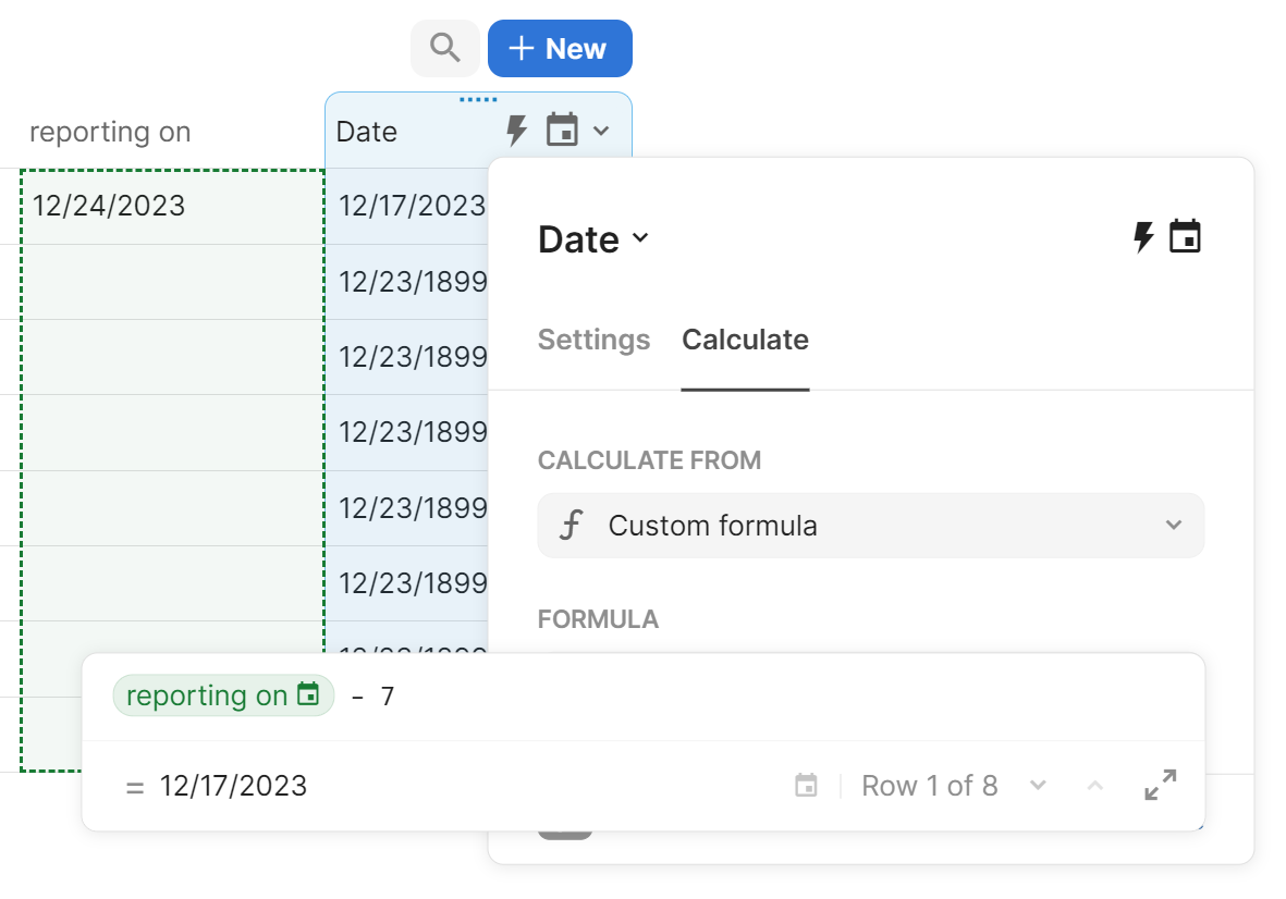

you see that the empty rows provide as a trip to the past.
maye you can share a sample doc, may this not be of help.
by the way, I used the ‘calculate’ to get here, so first the column is set on date as data type and second I calculate in the column
cheers, Christiaan

Here’s a visual of what’s happening:
