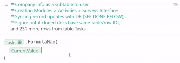

The second reason, however, is technical. Turns out, variables ($$[variable:...] items) are actually distinguished by their name, not an ID (and it makes sense):
Even if you supply some random arguments to the $$[] reference formula in place of actual grid ID and object ID, Coda will ignore those and replace them with the grid ID of the collection that CurrentValue is iterating over (I believe for coloring purposes only). And if you keep the IDs but rename the variable, it will resolve to blanks:
ezgif.com-optimize (81)
Doing the same thing with a row reference would do the opposite: still point to the specified object ID and row/column ID, and replace the name to reflect the actual name instead.
So this is why it’s not possible to have two CurrentValue variables — because unlike row/column references, variables are referenced not by any internal IDs but by names.
