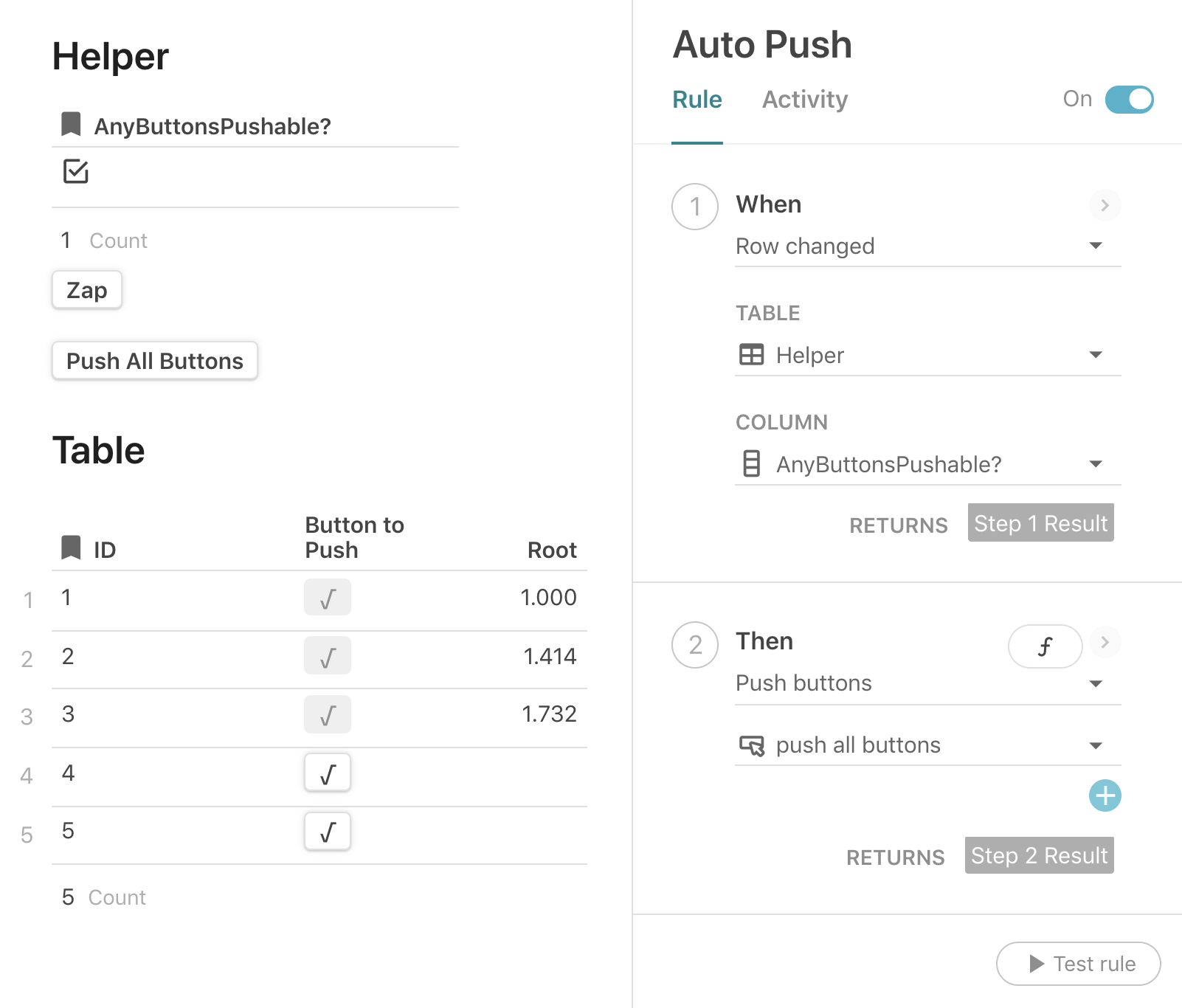

I have zapier creating new rows in a table. In that row is a button that I want pushed as soon as the row is created. The button is “disabled if” the button’s associated [results] column is blank.
My idea was to a helper table with one column and row that would count the number of blank [results] rows (the count is zero at first) and return true if count()>0, false. When a row is created in the first table, the count is increased in the second from zero to one and the checkbox returns true (was false). I created an automation to push the buttons in the original table, with the automation watching the true/false column in the helper table.
Everything works, and I have the automation set up:

But in practice the automation doesn’t automatically push the button. Should this be near-instantaneous?

Hey @Adam_Ginzberg thanks for the help. I’ve built an example that I’m inserting in the original post, take a look.

Yes I see the issue. We don’t currently support triggering Automations based on formulaic or calculated data changes. In your case, you are watching the AnyButtonsPushable? column which is formulaically calculated for updates. This is definitely something we want to get around to building, but haven’t gotten to yet. While you’re bringing this up, I agree we could definitely do a better job of explaining why this isn’t working in Coda.
In your case, a slight modification to the Automation so that it triggers on changes to Table (the table that Zapier is adding rows into) should do the job. In this scenario, that should have exactly the same effect.
@Adam_Ginzberg can you explain a bit more about the ‘slight modification’ … I don’t understand and would really like to get this working! Thanks ![:slight_smile: :slight_smile:](https://emoji.discourse-cdn.com/apple/slight_smile.png?v=9)
Sure @Johg_Ananda! I copied the doc you used in your example and made 1 tiny change to the automation and removed the helper table. How does it look now?
That was helpful @adamginzberg64 . I was able to duplicate the functionality in your doc, and set up the same automation schema in my doc. The mechanism is firing upon a new row (zap), however it isn’t pushing the button. I have tried directing the automation to push ‘all the available buttons in the table’ and also to push ‘a button to push all available buttons’ and both attempts give me an undetailed error:
