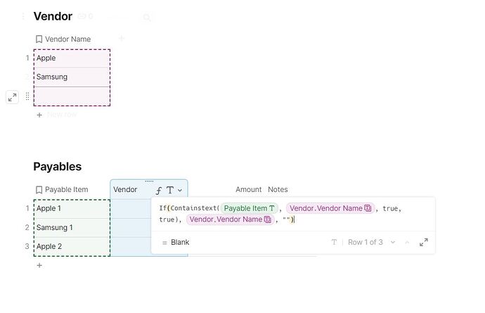

Im trying to get a column to return a certain value if the row contains a value from another table, but it doesnt seem to work. What am i doing wrong?

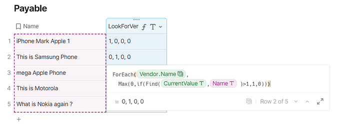

Not sure this is the easiest nor the most generic solution, but let’s go ![]()
I added the automatic rowid to your VendorTable, but that can work with any unique key you want (in my case a number)
First step, I would run through vendor table using ForEach(), to check if I Find() the current value of Vendor Name INTO Payable table (and not the opposite !). You can see that if you have a positive number, it’s linked to the vendor you’re looking for, a -1 si that you found nothing. You can see there that we’ve already found in which row of vendor table the good brand is !
Then, we make some arrangement to convert -1 to 0 and the positive number to 1, boolean power !
OK, now that you know the position of your good vendor name, let’s make a sumproduct to convert this position to the row id of the vendor you want
And then, just conclude by filtering the vendor brand you want ![]()
Assuming that
- you vendor table name are unique,
- you have only one brand in your payable name
- the ortograph is OK in Payable name
you can do any stupid text including the brand, it will find it !!!
I hope it can fit with your needs ![]()
Quentin

Hi @yscias
Here is the way to create the column “LookForVendor” with ContainsText :
Then you can use the same end of process !
Quentin

Actually if you read the doc of ContainsText, I just apply the explanation
- Where do you look for the brand > in the Name in Payable database
- What do look ? The brand, in Vendor Table
