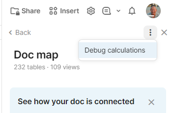

Hello @Alan_Edmonds ,
Are you using “debug calculations”:
It has helped me to find (and solve) bottlenecks in my docs.
Turn of calculations in your columns one by one (I disable calculations by just putting an ''x" at the beginning of a calculation, but you can also comment them out) and if your table is working properly again, turn them on one by one. Combined with the debug calculations you will find where the problem is.

I appreciate the response Joost, and thanks for providing that advice about Debug calculations! It turns out that once I deleted the button columns, the table began functioning as normal again.
