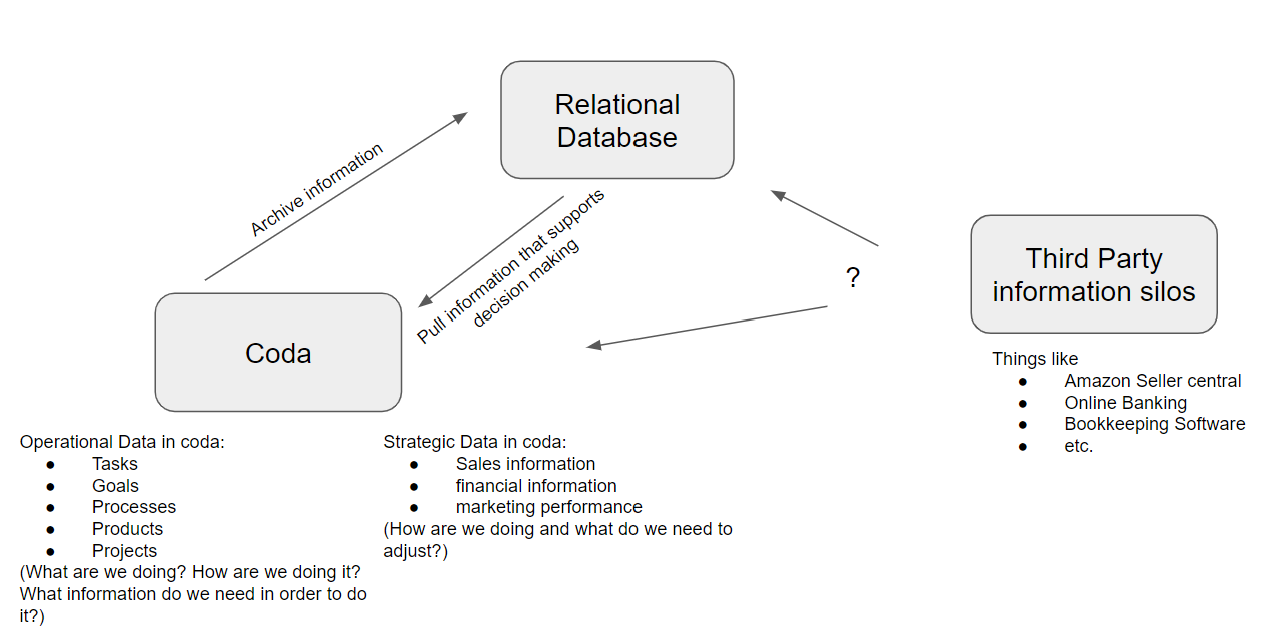

Thank you very much for your replies. Do I understand correctly, that the major constraint with coda would be the size of tables, since that will negatively impact performance?
Are you saying coda tables would be the place to store operational data with “historic” information being archived to another database of sorts and strategic information should be stored in another place?
I drew this up in order to visualize the idea that I currently have:
This would ensure that tables in coda could stay relatively small and we can at the same time draw insights from bigger information pools while staying in coda.
Another question that came up in this process would be:
In order to download data from the third party information silos. Would it be more convenient and potentially cheaper to do so in coda (maybe a dedicated doc for handling each source of information) and then push historic data (more frequently for higher density information) to a relational database?
For the general architecture in coda I would be using separate docs for different functionalities and using sync tables to cross reference information.

We are a small company only getting started. At the moment we are two. Hard to say how many people we will scale up to. Lets be overly optimistic and say 20.
  1. so tasks & OKRs for 20 people. If we assume 20 Tasks per user per week that would be 1600 tasks per month. if we want to keep them for a month after finishing that’s 3200. With 400 in a pool of potential tasks for the future that’s a table with 3600 rows.
  2. OKRs would be max 5 per person + 5 for the company and maybe 5 per department. That should not be an issue.
  3. products. we would store information for things like “dimensions”, “sourcing prices”, “manufacturing information”, “manufacturer contact info”, etc.
    Even if we end up with 60 products that should be manageable within coda?
  4. Projects & Processes. I will assume that we are running no more than around 10 projects at the same time, which would be a lot and even then I don’t think these would generate large amounts of data.
    All of these things we are handling in Google Sheet at the moment.
then for the strategic data:
  1. sale info. Let’s assume we sell each product 400 times each month. that would be 24k entries a month. Around 6k a week and around 860 per day. This is information I would hold in a relational database. I would pull this data daily from it’s source through coda and then push it to the database / pull it straight to the database.
  2. financial information & marketing performance. I would handle this information similar to sales info as it will be just as much or more.
    This info could be stored and handled completely on the side of the relational database with no touching point to coda.
    Coda would, in this scenario, only come in and request (aggregated) information in order to display it in coda so we can make informed decisions.

Hi Kevin,
i do not see any problem with the data volumes that you are mentioning. Hopefully somebody with better experience with Coda performance will chime in as well. But what your are describing is well within the limits.

Just on your “third party information silos” - That is where Zapier and integration packs would come in. Ido not know what accounting software you are using, but I know there has been people doing some work on integrating with Quickbooks, and there is a pack to integrate with online banking. It might be still in beta, not certan.
Regards
Piet

Kevin,
This confuses me, but I’m sure you have a keen idea what the process should be. My observations could be a little wonky, but here it goes.
  • If the sales transactions are being managed external to Coda, I assume you needn’t replicate the transactions in their entirety in Coda to gain an effective visualization of daily sales activity or even establish a daily log of sales or other aggregations.
  • We often believe that transactional data needs to be represented in discrete rows. Imagine a case where dozens of customer touch points occur but a single record is able to store them as structured JSON data objects. I’ve done this in Airtable and Coda with optimizing results.
