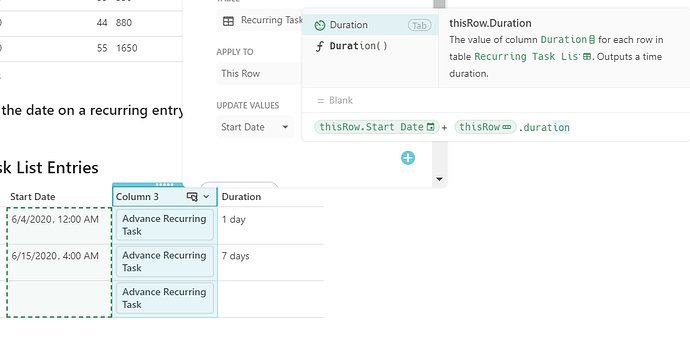

I would like to take a value in a table record, manipulate it and store it back in the same row. I just cannot find any documentation on how to do something like that. The closest that I get to it, results in the values from all the rows being included in all the rows, as in the picture below

I have figured out a way to do this - this being a row level calculation done from an automatization rule.
(Practical example, increase the startdate on a daily task once every day)
Prior attempts:
I have not been able to isolate a specific row from the automation rule. Everytime I access “Start date” from the automation rule builder, I get back the list of all start dates in the table. I cannot use ThisRow, because when I use ThisRow, I am not able to link it to a specific column. (I also found out that one does not seem to be able to manually write the formula, it needs to be built using the drop-downs and the tab. (Or Click))
What I ended up doing, is to create a button with the formula “Start date = Start date +1”. Then I have an automation rule to push the button early in the morning.
What I still have not been able to do, is to add the value in the “Duration” column to the “Start Date”. So I will have to write separate buttons for daily, weekly increases, and add an indicator column to distinguish between daily and weekly tasks. Monthly and annual changes will take some more coding to adjust for the number of days in the month. or days in the year.
Manana
Aha - Update.
It turns out that even if a column is not available in the formula builder, it is still accessible if you manually type it in.
So you need to manually start typing “ThisRow”. And then you need to manually start typing the column name that you are looking for, in this case “Duration”.
