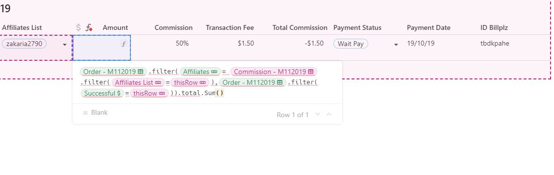

help… i try your formula but not working
@Pesan_Paktam : Could you post the formula you used ? :slightly_smiling_face:
this

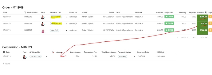

Not sure you need that many Filter() to get the Sum() of your Successful field in the table [Order - M112019] and I think you got no field called total so the formula can’t find it thus it can’t work.
You’re also comparing a field called Affiliates but in your table [Commission - M112019] you apparently wish to compare a field called Affiliates List.
To get the Sum() of Successful filtered by Affiliates List you just need to compare those 2 Affiliates List fields and then get the Sum() (If this is effectively the problem)
Could you try this ? :slightly_smiling_face: (I hope I didn’t make any spelling error writing it)
[Order - M112019].Filter(Affiliates List=ThisRow.Affiliates List).Successful.Sum()
Or this maybe :slightly_smiling_face: :
Lookup([Order - M112019],Affiliates List,ThisRow.Affiliates List).Successful.Sum()
i try not working…
It’s because you change the format of the field Affiliates List to a Text field :slightly_smiling_face:
Before you were comparing 2 List now it’s a List and a Text which can’t be compare :wink: “like this”
I’m not sure where your Affiliates List gets the name of the affiliates (I’m assuming it’s in the field Affiliate ID and I could be wrong) but could you try this ? :slightly_smiling_face:
[Order - M112019].Filter(Affiliates.Affiliate ID=ThisRow.Affiliates ID).Successful.Sum()
