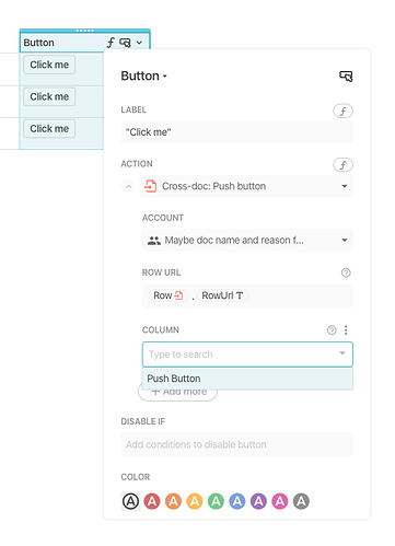

Looking for anyone who’s been able to implement Cross Doc Actions - hoping to re-build a few of our docs employing them but we’ve not been able to get the Cross Doc Action “push button” to work properly. When you go to connect the action to a column, it doesn’t find anything. Any one using Cross Doc Actions that have had any issue like this? we’ve been talking to support this last week and they confirm we are implementing it correctly but it’s not working - they even got back to us to have us try using them only on the main table rather than a view (super odd, since one of the whole points of cross docs is to be able to only bring a subset of a table to another view) but that hasn’t worked either. I’m guessing we are missing something. Any ideas?

I’m getting the same result as that screenshot in the original post.

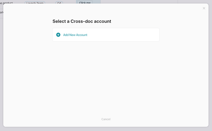

To add an API connection, you can follow these steps in the secondary doc where you’re setting up the Cross-doc Actions button.
Open your button settings and under “Choose Account”, click on “+ Set up another account”.
You may see connections listed here already and there may be one that works. It needs to connect to the correct doc and it needs to have “Read and Write” permissions. It’s okay to setup an additional connection individual buttons though too. To setup a new connection, just click “Add new account”.

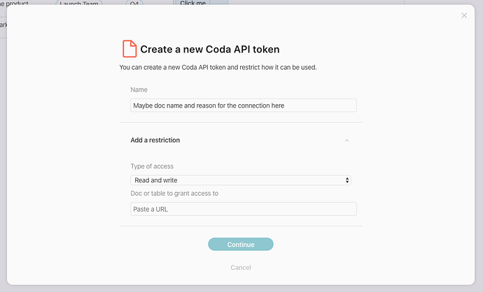

Choose a name that’s descriptive enough for you to know what it is if you need to choose it from the list again. And it must have “Read and Write” access. Then click “Continue”.
And click “Complete setup”.
You should now see your button options listed.
