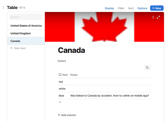

For example, say I have a [Colors] table with a new row for each color.
Then I have a [Flags] table with a linked relation to the [Colors] table. Several flags are linked to the colors red, white, and blue. Then, in the mobile app, I discover that a flag that does not contain red was accidentally link to red. How do I undo that link? I don’t want to delete “red” because it needs to remain for all the other flags. I could try to make a note to go back and fix it when I am at a computer, but I really want to be able to fix it right there on my phone. Is this a bug or am I missing something?

Thanks for the reply. Here is an example doc.
Here is a screen shot of the doc on a computer.

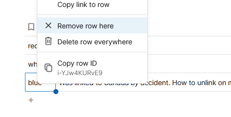

When I right-click the item I want to unlink, I can choose to “Remove row here”.
But on the mobile app, I don’t get the “Remove row here” option. The “Delete” option deletes the row everywhere.
I don’t want to delete the entire contents of the column. I only want to unlink one row in a many-to-many relationship.
