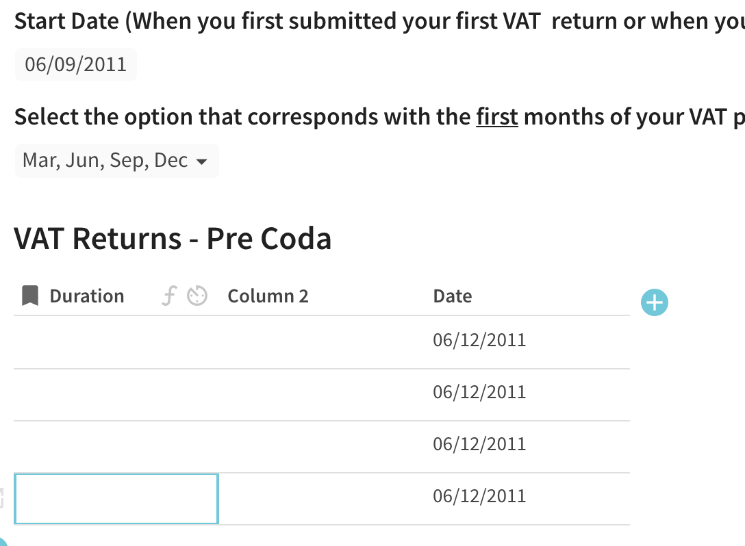

@nigelHi the following formula worked but it’s not the ideal way you suggested.
RelativeDate([Start Date], 3 * (thisRow.RowId() - 1))

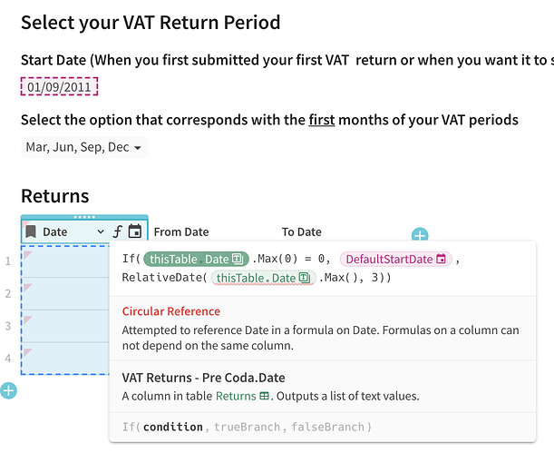

I cannot get the following code to work:
If(thisTable.Date.Max(0) = 0, DefaultStartDate, RelativeDate(thisTable.Date.Max(), 3))
Currently there is nothing in the date column?
See attached my document. I added a returns 2 table to show it working correctly using your other method.
If this is the case wit the 31 days, seeing as I am wanting the beginning and end of a month, could you use endofmonth as the extra few days wouldn’t matter?
Thanks by the way.
Juan, it looks like you missed the crucial setting of the default value formula on the date column. I added it (see pic below) and it’s working fine.

Juan, it looks like you’re trying to add this as a column formula rather than a default value formula. Open the column format menu for date and enter it under “value for new rows”. See https://help.coda.io/faq/editing-docs/how-can-i-set-the-default-value-for-a-column to learn more about default value formulas.
Nigel.
You’re a star, not only does it work, I now understand it. Thank you.
