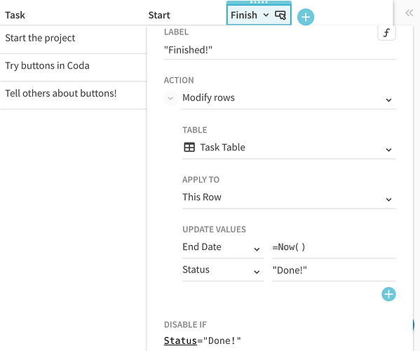

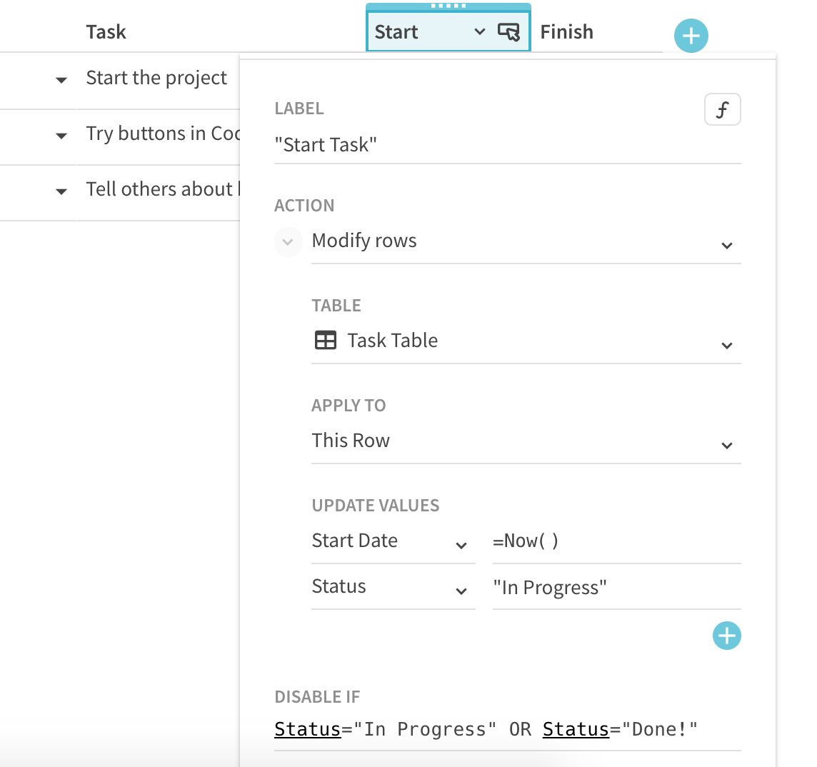

You could also try buttons. This would give you a date of when the button was clicked…
The Start button configuration looks like this:

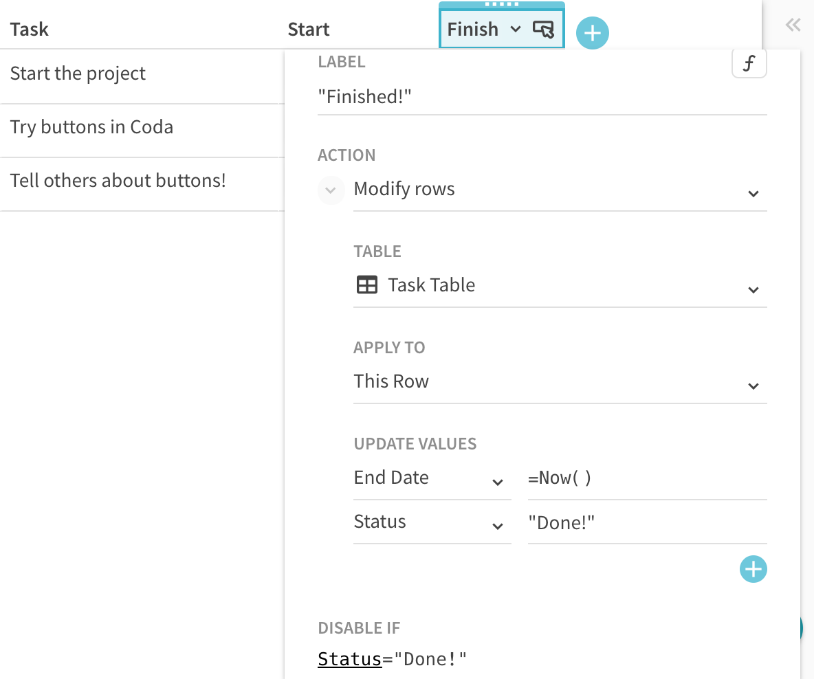

The Finish button configuration looks like this:
I guess in that case the ‘Start Date’ will keep changing (for instance to 10/6 the next day) as it remains in ‘In Progress’ state? Which is not what I want.

I tried this solution and could not for the life of me get it to actually place a date in the column. Not a big fan of the buttons either.
