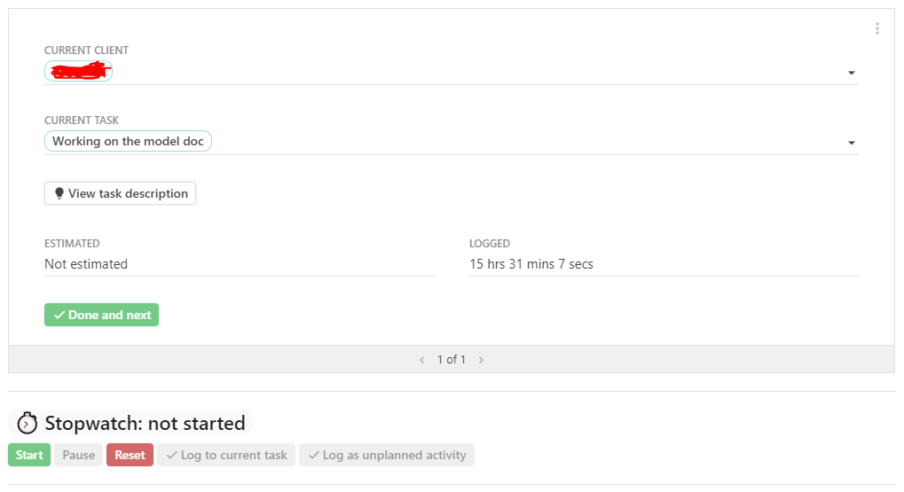

And this is a table, in Detail view to simulate a form:

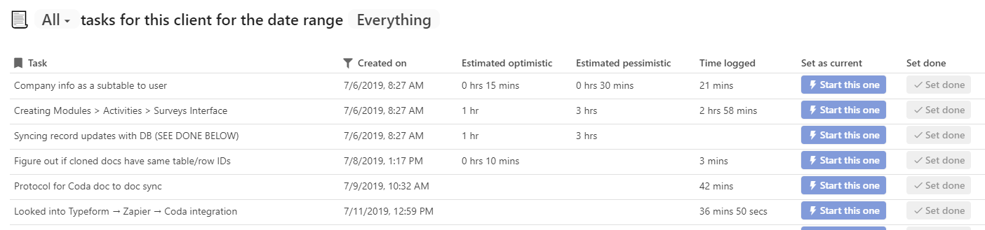

When I use the stopwatch to track time, the “Log to current task” button adds tracked time to what’s selected in that form.
And here’s the table that shows all tasks for selected client, and each task has a button to modify the “Current task” value to set thisRow as a current task:
