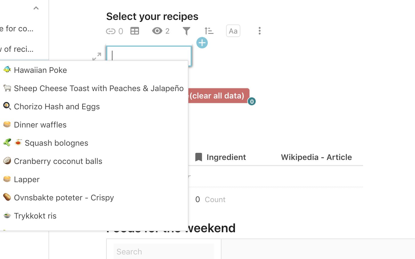

But what you could do, is create a mini table with a multi-select list and a button Clear like this :
Thanks for that clarification and help.
It lead me to a solution that works. Just hide everything around
